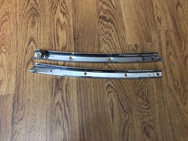

Can someone educate me on these?
I have this pair of moldings and was going to replace the blow-out clips but then it dawned on me that this cannot be for a 67 Camaro convertible because it has vent windows.
Are these only for 68/69 Camaro convertibles and possibly Firebirds of same years?
I don't remember where I got these.

This one is for a hardtop I believe. This was on the auction site recently.

After some searching I see these for 67 Camaro's.
Top is convertible bottom is hardtop.
Anyone know if this can be purchased? It looks like I possibly can use the ones I have with clips removed?
EDIT: Well I think I have answered my own questions here. These are NOT reproduced as far as I can tell and 67's are definitely unique with no clips but the channel is still needed for the rubber weatherstrip to be inserted into.
I think I can make mine work without the clips. The holes line up!
