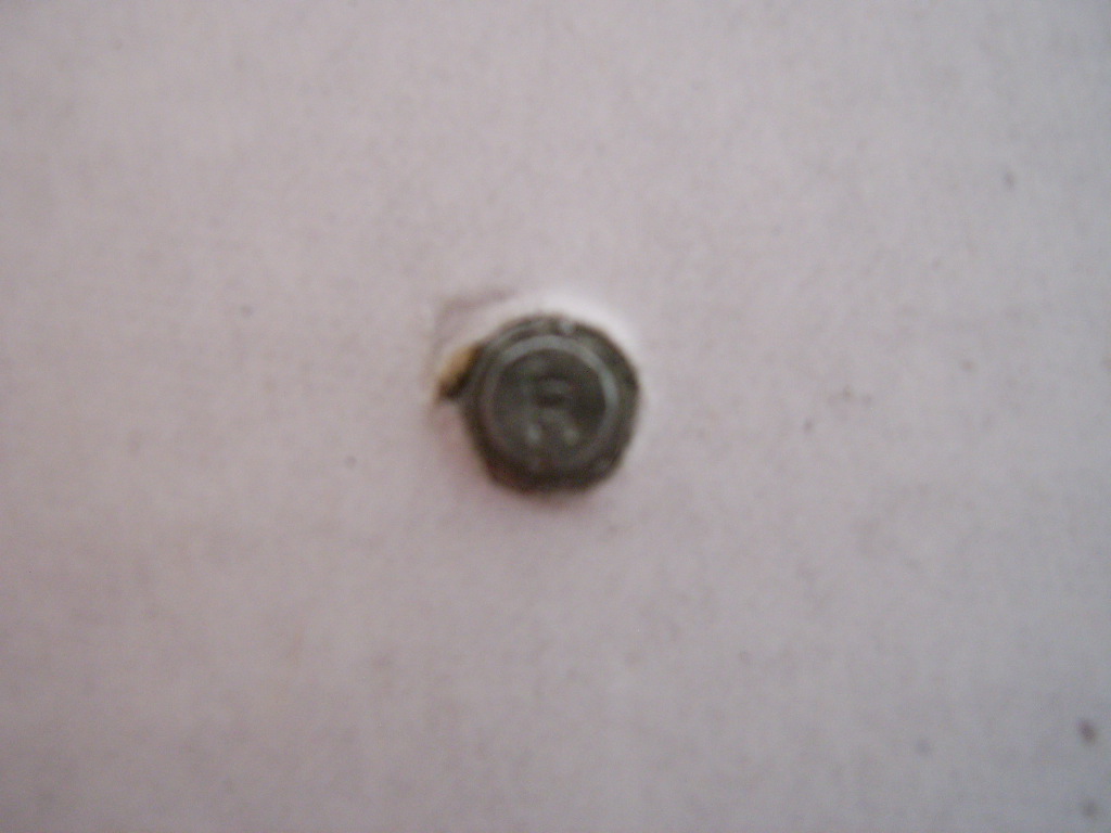

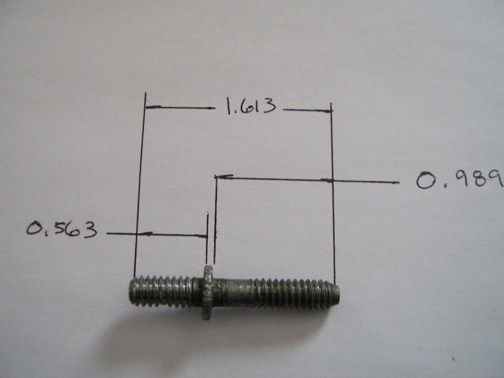

1/4-20. R stamped carb side. '70 Z28 04B 1st design.

FWIW verified within a few thou of my 04B carb stud.
Were these zinc plated or bare?

No remnants of plating that I can see. Stop flange was mangled by what appears to be by a pair of vise-grips. I'll reshape it on a lathe if I can't find a nice one.

Dug a little deeper and it would seem that they were zinc plated. Just finished mine.

Good info. I just acquired a set of manifold carb studs and their ends, manifold side, leave no doubt that those were also bright zinc plated.
