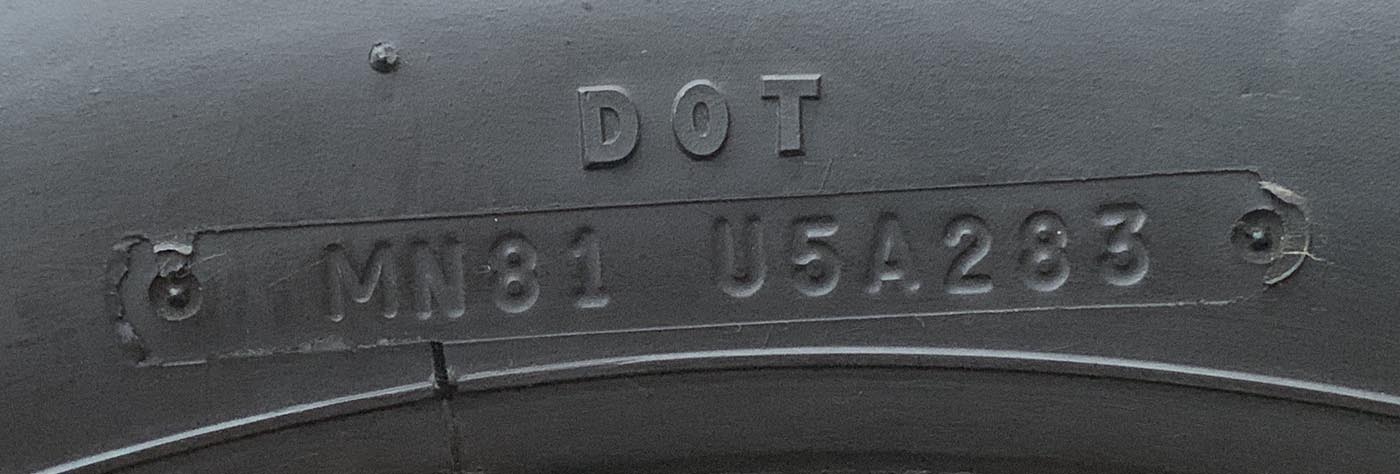

Looking for a little help to determine dates on some vintage Goodyear tires. Every time I think I get close to figuring out the answer the rest of the code does not make complete sense.
I believe 28th week of 1973
Unsure of most of the code letters.
Any links to websites that have good info on the old tire date codes, or firsthand knowledge would be appreciated.
Thanks.

28th week of 73 or possibly 83.
http://anghelrestorations.com/upload...tires_v1.3.pdf

I believe 28th week 73 is correct.

I concur on the 1973 year.
