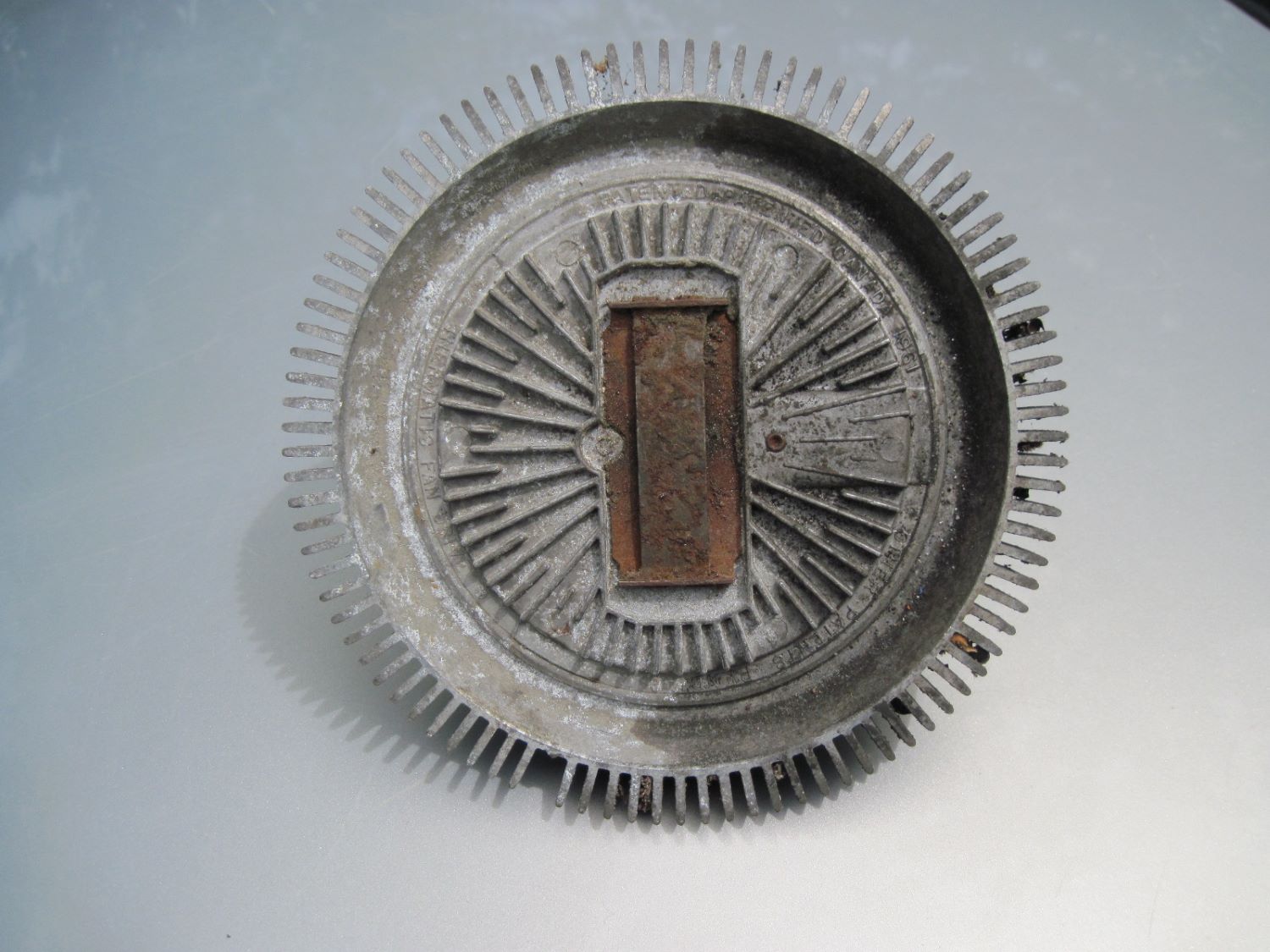

Going thru a bunch of tubs in the back of the garage I came across this. Anyone know it's application. I believe it's off a 67 or 68 GTo or Chevelle just not sure.

Sure looks like the hi dollar 67-68 z/28 or l78 clutch. What’s stamped on the edge of the steel hub flange?

Only thing I can find is what looks like a date. 11 26 or 28 66 sc

What do both the bolt circles measure?

They one that mount to the pulley is 1 3/4 inches and the one that mounts to the fan is 3 1/4 inches.

https://rover.ebay.com/rover/0/0/0?m...2F263559423547
Looks very similar, like Tony said. This is not mine.
Looking at the CRG cooling systems report, the 3.25" bolt circle Schwitzer should be for 67 68 solid lifter application.

Thats a 67 z28 or L78 fan clutch. Too bad one of the fins broke off.

Kirk Connell Corvettes could work his magic on it

BINGO ... just got my shweizer back from KIRKCONNEL no broken fins but bad bearing, seal, and leaking oil... 265 delivered back to me and it moves more air than a tornado now...
