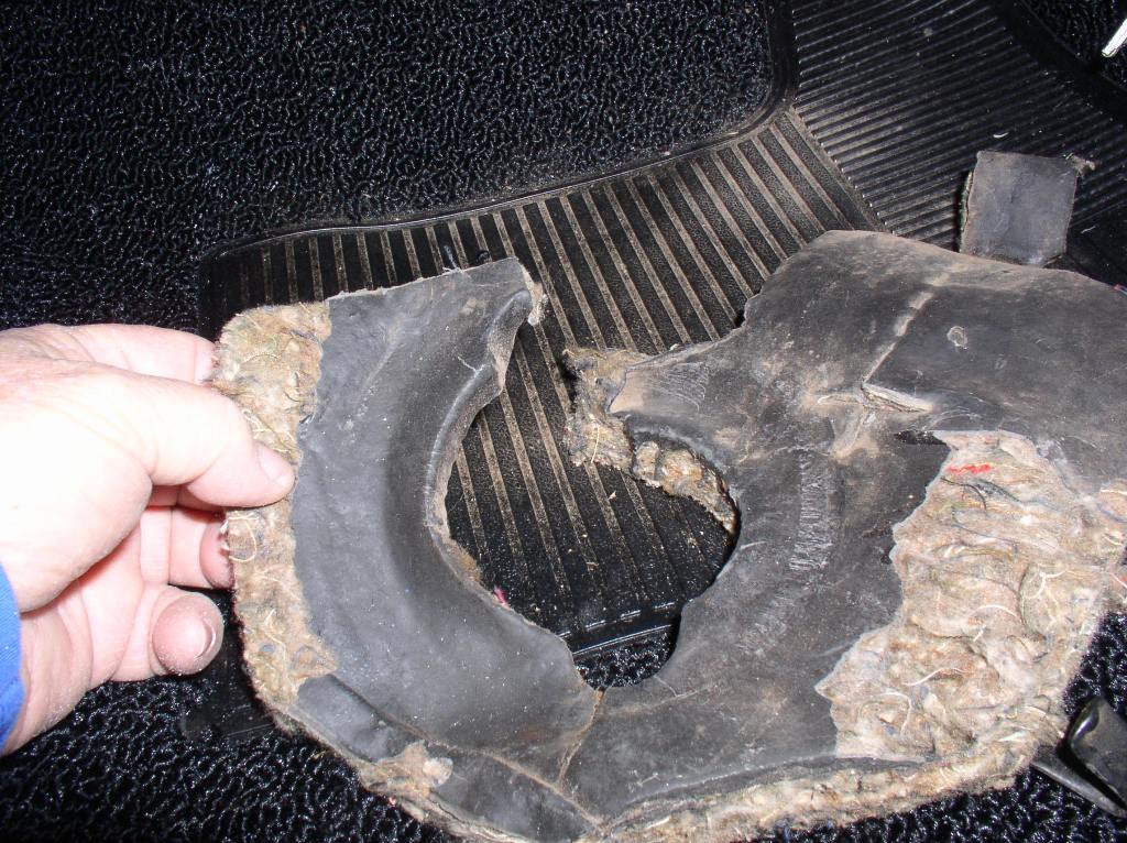

Old 12-13-2020, 02:14 PM
X66 714's Avatar
X66 714 X66 714 is offline
Join Date: May 2009
Posts: 2,046
Thanks: 3,526
Thanked 1,309 Times in 534 Posts
Here's some pictures of my original. It's split at the top...Joe

Old 12-13-2020, 06:08 PM
R68GTO R68GTO is offline
Join Date: Aug 2017
Location: Minster, Ohio
Posts: 1,322
Thanks: 2,221
Thanked 2,314 Times in 605 Posts
Thanks Joe, that tells the story!
