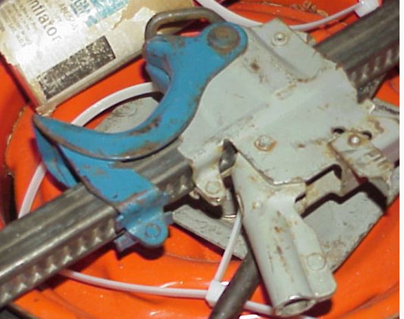

It's an original but may not be original to the car. In production, only the face was painted. Cars built with the VE3 bumper had an adapter riveted to the jack loadrest, usually painted blue.

Doubt it. Never saw an original with overspray on the brackets. Would have required a lot of masking.
Seen a few NOS, serviced in black primer.
