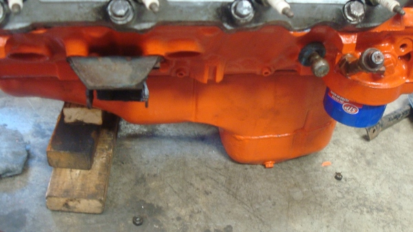

Regarding factory welded GM oil pans for the Mark IV Big Block Chevy, yes, they were manufactured for sale by GM with a GM part # 3879633 with a oil pan windage tray #3879640 in their performance parts/off road catalog back in the day ( 1960's ). I do know that the upper part of the pan resembles an early Impala (B-body) oil pan for the 396-427 engines but I do not know where the lower welded sump came from and if GM manufactured the pans themselves or had some other oil pan manufacturer weld them up for GM. Don.

I have a pan with the extended sump, but it must've been a 'home-made" unit. The one in Rick Nelson's photo looks great. Mine kinda appears 'ratty'.

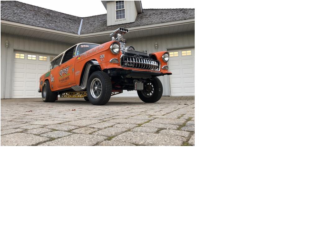

hi
here is a picture of my 55 nomad gasser .....was called the The "FREAK"
my wife is drag racing it in "Gasser" "Nostalgic" and "ONDR" classes up here
original ladder bars reach from the rearend up to where the tranny meets the engine...96" long
thought you might be interested
thx
chris
1970 citrus Yenko Nova

Old 11-08-2018, 07:46 PM
mockingbird812's Avatar
Location: Dayton
Posts: 14,424
Thanks: 917
Beastly looking car Chris!
Sam...

Here is one on a L88 I have. The engine was a over the counter L88 I do not know if it came like that or some one installed it after.
