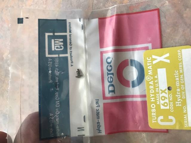

For reference...This is what you need.

The correct rivet is still available from GM under part number 8622361.
