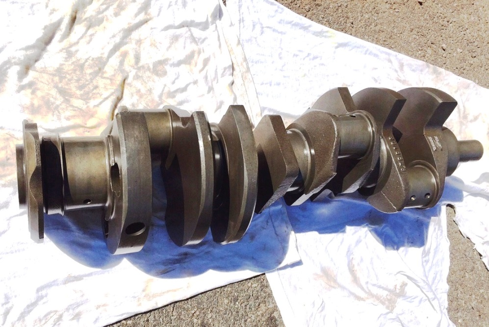

The engine out of our Yenko is just too crusty with surface rust and 50 year old paint that thermal cleaning will not do it justice. Our local machine shop (Tim Wilkerson FC owner/driver) owns the shop. Their tech suggested I use their Ampro shot peening machine to clean the engine. I will admit that all the blocks they had in house looked great though none were Chevy blocks. I was concerned about loosing the stamps of the front pad as well as broach marks though they insisted this would not be an issue. The pad on this engine is not in the best of shape and I would like to try and bring it back best I can. Before I make a $20k error has anyone here used this or a similar system to clean their blocks and what were your pros and cons. It has also been suggested that I make a steel bracket that protects the pad area so I will likely be doing that anyway but before I ruin anything I wanted to check. From all that I have talked to there is no issues with cylinders, bearing saddles or anything such as those areas.

The engine shop I use has what I would assume is the same machine. It rotates cylinder heads or whatever they put in it in the top and then there's some device in the bottom that throws shot up and cleans the block or heads. I've had heads done in it and they come out looking like new. This guy does mostly race engines and seems to like the machine real well

the ampro machine does not peen it, if thats what you are afraid of...its the best system ive ever seen or used..i recommend it...i would think youd notice a 50-75% improvement over whats there right now..i use it on pulleys and things like that, it doesnt distort or change the machine marks, etc..i really like it for resto stuff...BUT..ive never had a Yenko block either..i understand the worry..ive seen it bring broach marks up better...with out it changing the readability..if that makes sense
find the worst block you have..send it thru..judge yourself..thats exactly what i would do...
