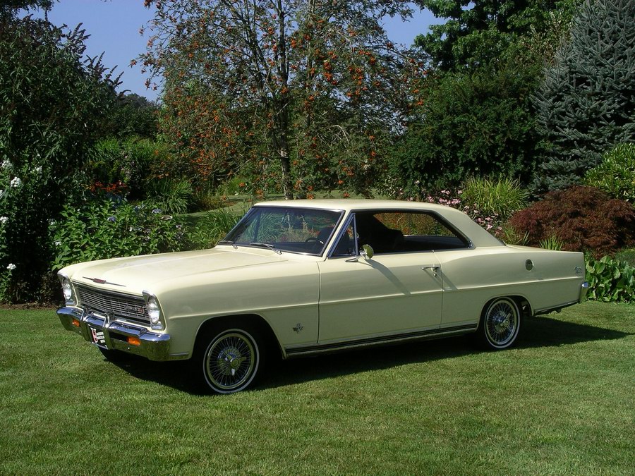

Nice looking car but once again claiming that the window sticker is original....
Paperwork on bottom of page:
https://www.mecum.com/lots/FL0118-31...olet-nova-l79/
Paul
[email protected]
Attachments - The Supercar Registry L79hor3.jpg 1966 Nova WS 123975 analysis.jpg

I gave as much detail as I feel is acceptable without explaining the correction to each error. We would prefer that anyone representing reproduction documents as original documents continues to make all these errors.
There may be additional issues but this should give you an idea why a buyer needs to do their research prior to making a purchase.
May also want to look at the authenticity of the POP. POP lists Rear axle as FO1230E: FO is fine which is a 3.73 posi with Metallic Brakes, however production date of 12/30 is 15 days after the NCRS data report shows the car was built of 12/15/65.

The sport steering wheel alone pegs this window sticker as a reproduction. There was no sport steering wheel option in Chevy IIs until 1967. Based on the fact that this is incorrect, you also have to wonder about the heater delete. Very few Chevy IIs had this option. It wasn't even available in Canada ( I wonder why!!). Most of the 2nd generation Chevy II factory heater deletes I've seen were cars shipped to Hawaii and they all had it coded as an 'H' on the cowl tag.
Bob
The Canadian L79 Registry
Old 01-18-2018, 08:18 PM
novadude novadude is offline
Join Date: Aug 2006
Posts: 739
Thanked 49 Times in 35 Posts
A minor point, but those hubcaps are wrong from a Nova, and the wheel width / offset is wrong as well. Not to mention the fact that Super Sport package included full wheel covers in 1966 (Nova - does not apply to Chevelle). You couldn't get an SS with dog dish caps.
