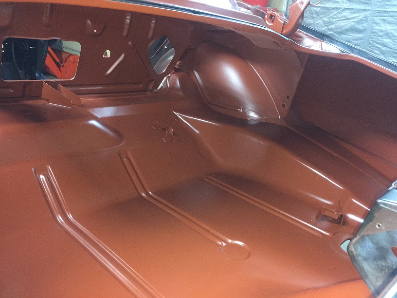

On the subject of the SPI epoxy, I spoke to Barry and have been working with his Epoxy for a couple of years on my 70Z project. Per Barry's advice and based on my own working experience, I get more consistent results in the gloss / flat appearance using the epoxy versus urethanes, whether they be clears or solids. For the black, I used anywhere between 3% and 8% by weight flattener before adding the hardener.
On a side note, to duplicate the 70 Norwood red oxide, I like 8% black and 5% flattener by weight added to SPI's red oxide epoxy (pre-hardener). I understand the red oxide appearance could change based on several factors, but based on original no-UV exposure panels I have, the above matches very well.

Steve, I dont comprehend your 8%, 5% etc.......
What brand/part number Flattner are you using ...I'm familiar with PPG DX-10.....
Are you using flattner because the SPI Red Oxide is too glossy as might be the
situation with the black.........

Chuck,
To the SPI red oxide, I adds 8% black, (weight of the red oxide x .08), then add 5% flattener (Red+Black weight x .05). All materials are SPI including their flattening agent #940-4....and yes, Barry approved using the flattening agent in the epoxy. Here's some pics of the red oxide results on my 70Z project:
https://www.yenko.net/foruhttp://www....1&d=1504883799
