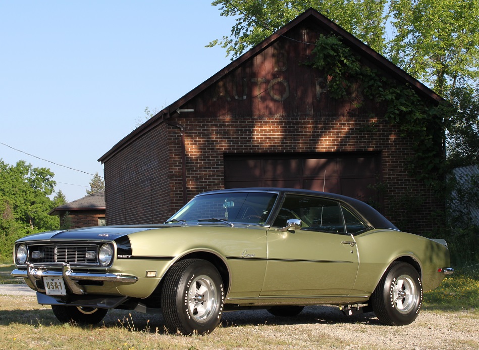

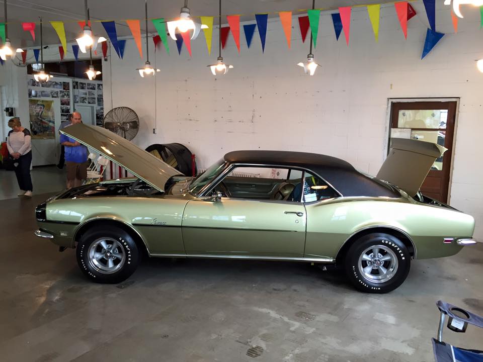

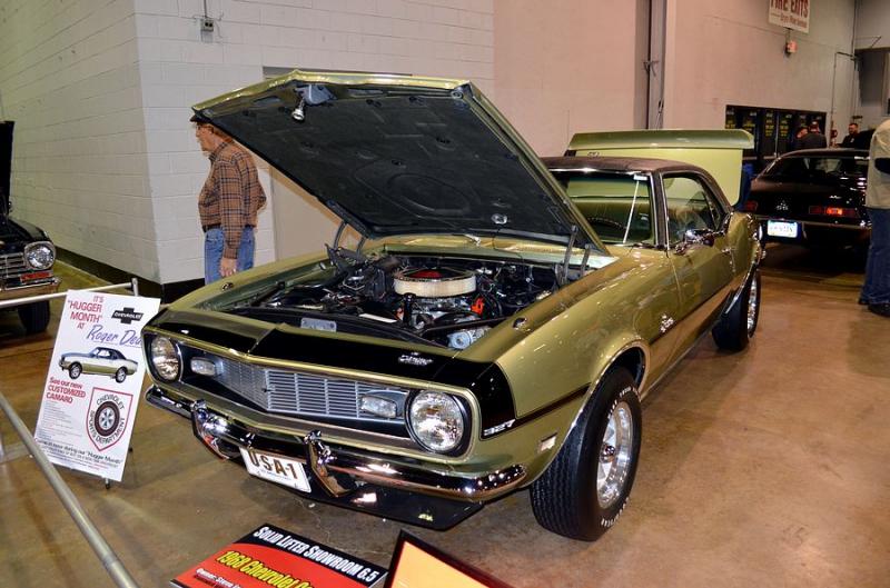

Looking to find the correct formula(match) for the 68 Ash Gold paint color....
Interested in what has worked as of now to match this color....I know the paint code from 68
but that's what was used back then....Assuming its all different today?
Thanks

Ash gold

Assuming this is the correct color?
