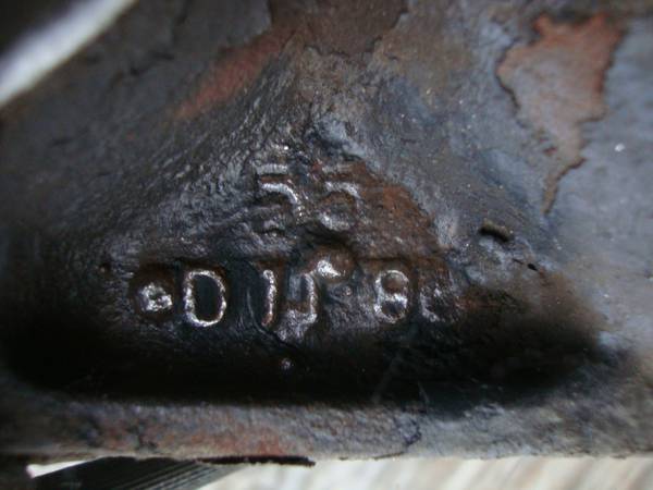

looks pretty bad to me you can be the judge

Printed for posterity.
Original 69 Chevrolet Camaro 427 COPO 12 bolt rear end. This is an original BE rear end that was in a race car for many years. Currently has 4.56 gears with spool, Moser axles, and c-clip eliminators. Casting date is D-11-9. Assembly date is BE 0416G2. Will need original spring pads installed and ladder bar brackets cut off to go back into an original car. This is a must have for any original COPO or Yenko 427 car. $5500. 609-320-8025 Matt. No texts.

It's common to see the marks in the area where the axle code is but, I wouldn't think the BE would still be so clean... Looks like a bad re-stamp to me. Not even similar fonts to an original axle code.

I am very skeptical.

Sorry, not "buying" it...

I don't have any BE rears with that date. I do have BL rears with that date though.

looks like D 11 9 cast date. are you saying that it was a BV or it's a '68 BE?
