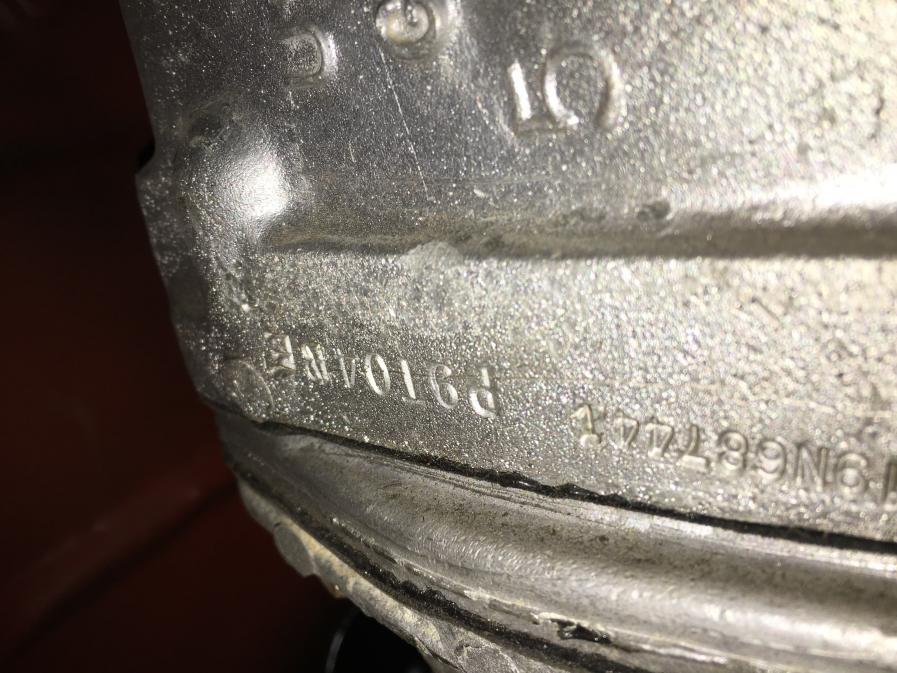

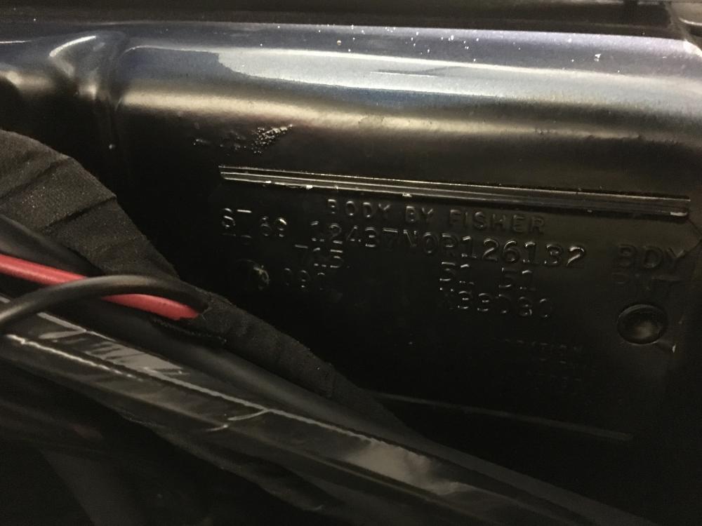

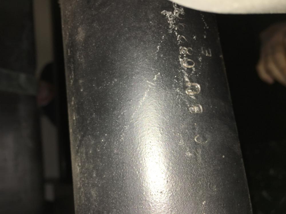

Pics of trans, rear end and trim tag. Sorry for the orientation.....learning new posting method. 😀

On the axle you can see the C stamped before the B and the restamped U. So it was a CB- something axle. The U is definitely stamped over some other letter.
The trans VIN is a restamp too. The cowl tag is one of those early repop tags and very easy to detect.
The expert mentioned aint exactly a trustworthy resource. I had my own dealings with him before.
