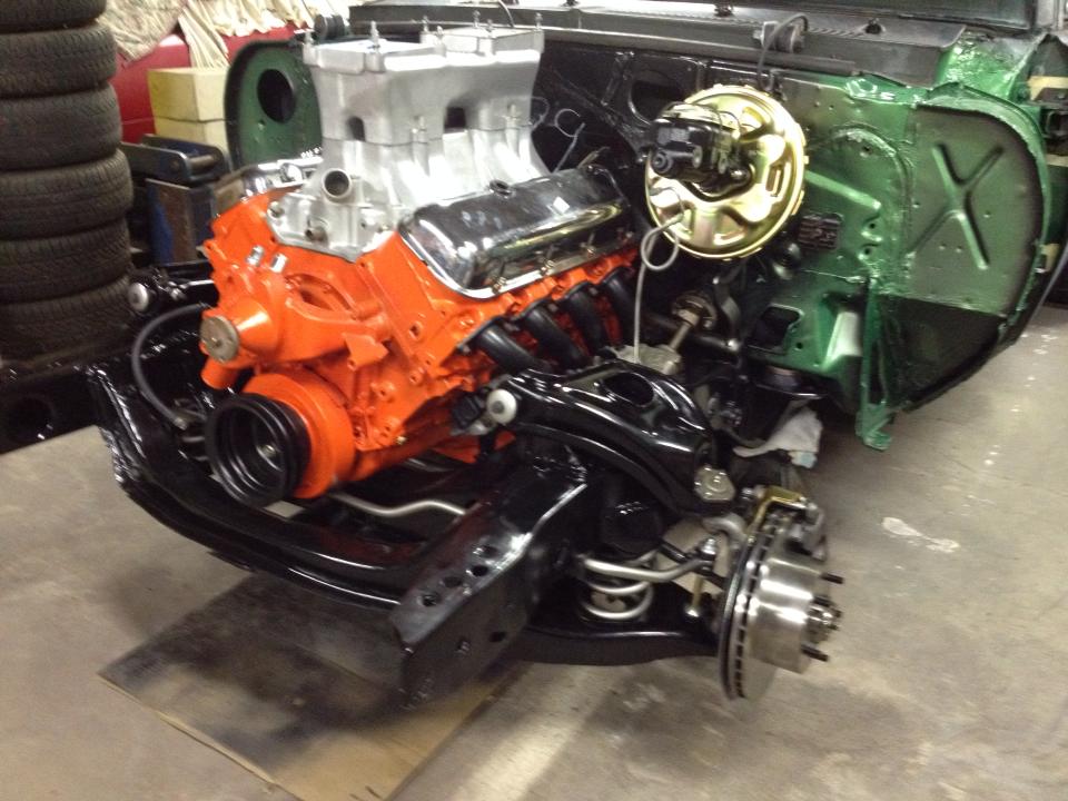

So, I have this Mallory setup, but stupid question: how do I determine the #1 spark plug wire on the cap? I had picked up a used unit some time ago, but no instructions - and I'm getting close to the point of needing to install this thing and fire the engine....

Marlin,
You can make #1 anywhere you want it to be. With the engine at TDC on #1 firing stroke, put in the distributor with the rotor pointing where-ever you want, then just put #1 plug wire in the cap hole above it. Follow the cap holes CW with the firing order.
