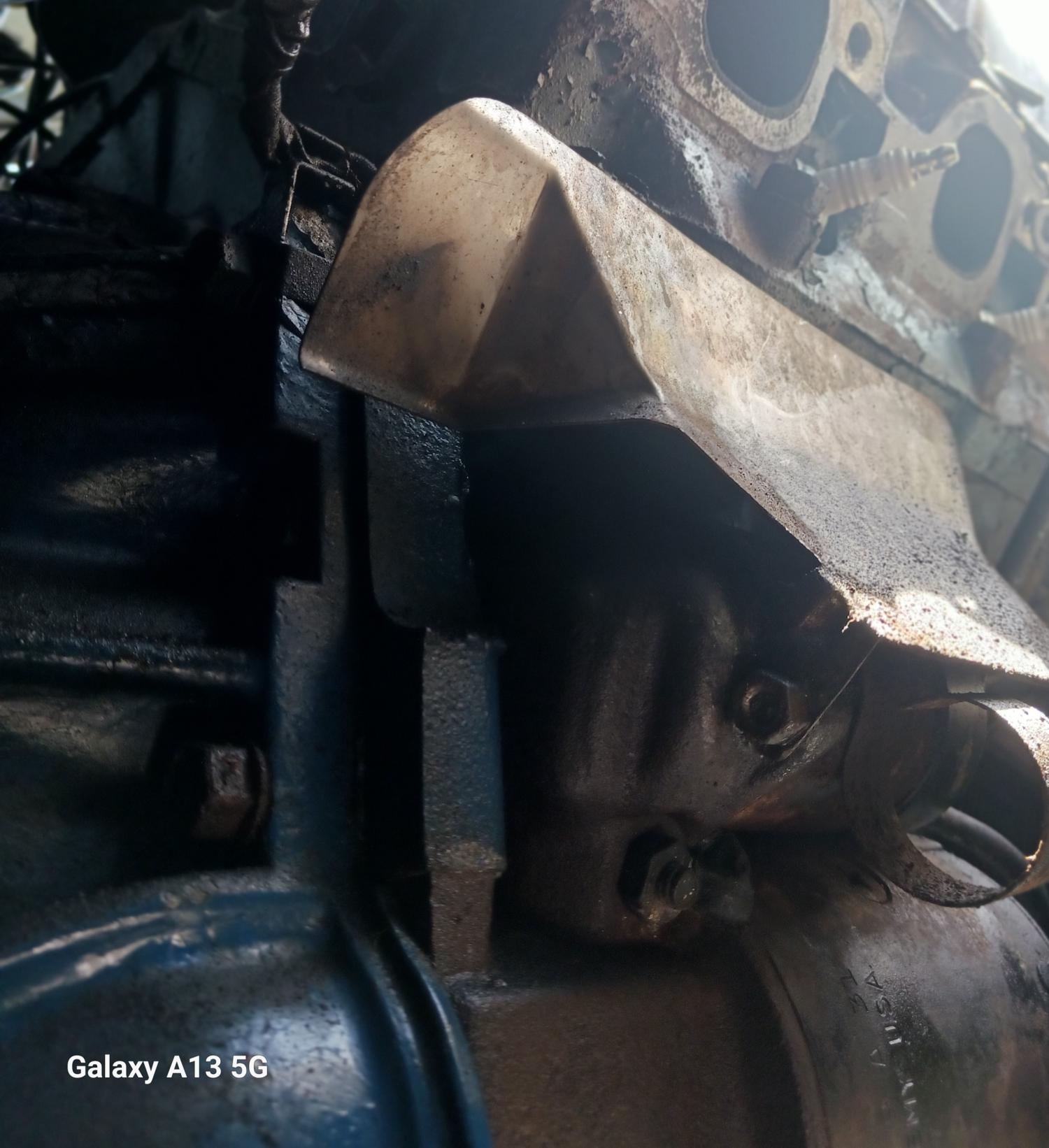

daveg's Avatar
daveg daveg is offline
Join Date: Jun 2024
Location: NW WI
Posts: 459
Thanks: 62
Thanked 590 Times in 188 Posts
May help.
Factory one.
All I have of starter- heat shield.
Slotted tube nut holding heat shield to solenoid bolt is not back on in pics.
It appears to be phosphate like wiring clips on bell and solenoid.
Old thread but answer is for Chuck.
