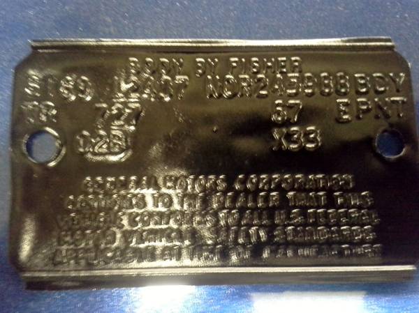

<span style="font-style: italic">&quot;Our Camaro was a mess so it was converted into a tube chassis race car with lots of fiberglass and a sheet metal firewall. If you are missing your Z28 trim tag or building a Z28 tribute car here is your chance to get the finishing touch. 785-207-0830</span>
X33 Z28 with Style Trim
12437 V8 Coupe
NOR245988 Norwood Plant
57PNT Fathom Green Paint (looks like code 67 Burgundy?) (E Parchment V/Top)
727 Ivory Standard Bucket Interior
12B Build Date 2nd Week of December
$350.00 obo

<div class="ubbcode-block"><div class="ubbcode-header">Originally Posted By: Mr70</div><div class="ubbcode-body">
12437 V8 Coupe
$350.00 obo
</div></div>
I believe the tag is a reproduction/fake
www.vintagecertification.com

<div class="ubbcode-block"><div class="ubbcode-header">Originally Posted By: paceme</div><div class="ubbcode-body"><div class="ubbcode-block"><div class="ubbcode-header">Originally Posted By: Mr70</div><div class="ubbcode-body">
12437 V8 Coupe
$350.00 obo
</div></div>
I believe the tag is a reproduction/fake </div></div>
No doubt a fake.

X3 on the Z28 tag [img]<<GRAEMLIN_URL>>/smirk.gif[/img]

Is there more than one place making fake tags or where do they come from? You don't have to mention names
Bill
Old 08-21-2015, 09:26 PM
Stefano Stefano is offline
SCR Sponsor
Join Date: Oct 2001
Location: Land of Lincoln
Posts: 9,061
Thanks: 5
Thanked 1,145 Times in 430 Posts
Default Re: 1969 Camaro Trim tags look out for
Yes, there are multiple business making up fake tags. Some advertise and some don't. Some have been in business for DECADES!
