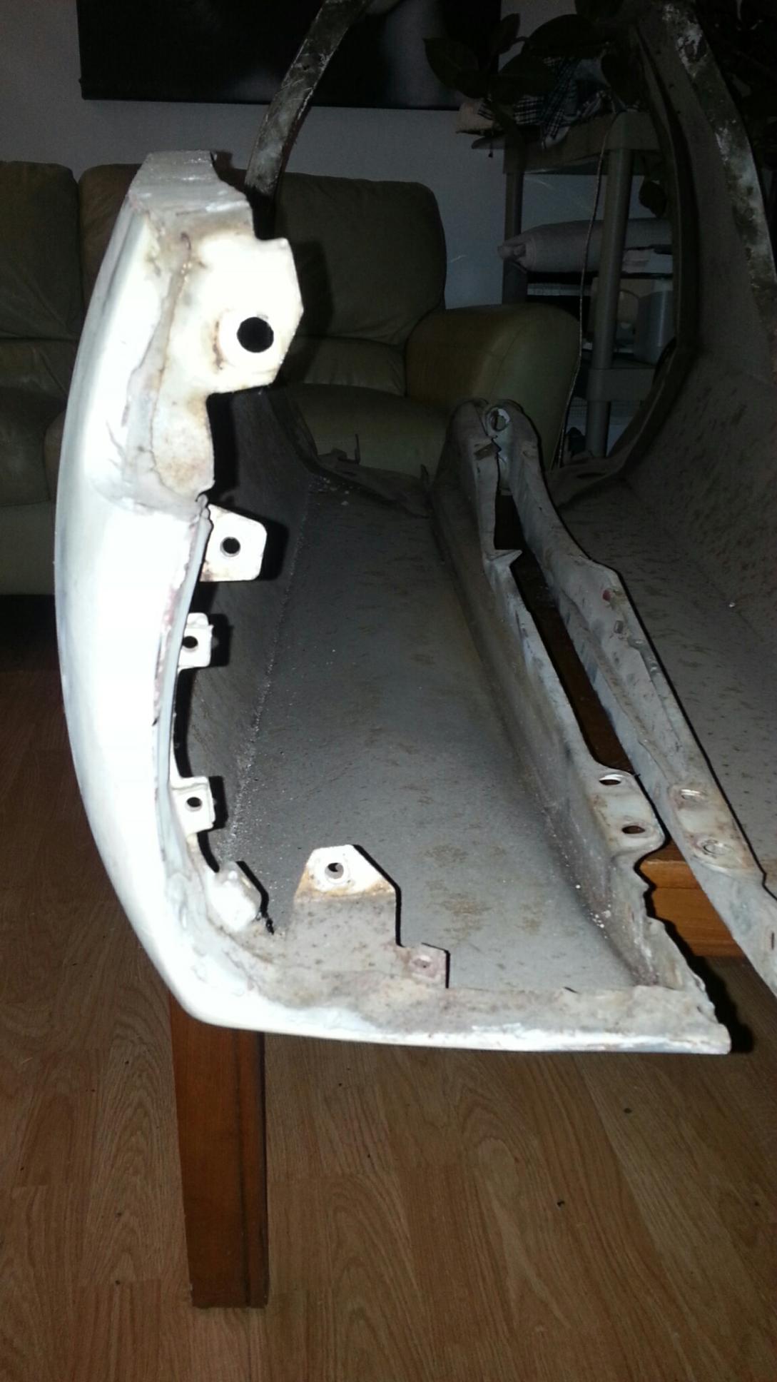

Default Is this a '69 RS Camaro Fender?
Thank you!

Do they have rally sport emblems???? haha... just kidding.....yes, I believe.....the deep brackets are RS

I have converted those fenders in the past by fabricating smaller brackets and vise-versa...

Thanks so much... as I thought.

There is a good comparison photo of standard and RS fenders at CRG, go to http://www.camaros.org/options.shtml#id and scroll down a little (picture is on the left hand side).

Those are RS ..... STANDARD cars accept RS fenders. A Standard fender needs that extended bracket for RS applications.
There are Camaro venders who sell the RS brackets for Conversion.
GM NOS 69 Fenders stamped and sold into the early 90's were nearly all RS for standard use as well.
You'll see mostly RS fenders available now in NOS than Standard.
