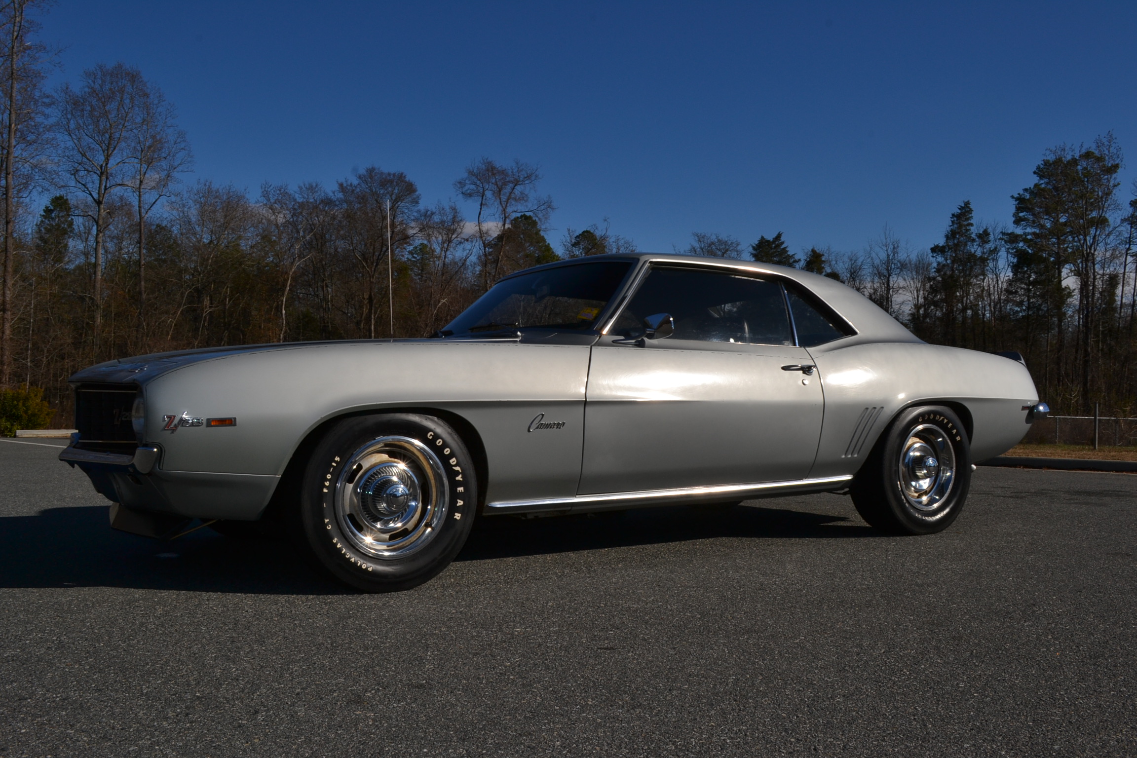

Last one

Z looks Great! Nice patina, would love to see more.. [img]<<GRAEMLIN_URL>>/worship.gif[/img]

You can try some Imperial hand glaze from 3M. You can buff with it but it seems that you have done that so rub on with a round applicator {Damp} by hand in a straight line{always follow body lines when you do ANY waxing} NO CIRCLES!!!!
I use the 3M Imperial hand glaze on my black 67 Nova that is Lacquer paint from 74 and it fills in any {glaze} scratches. It will be a tad tough getting off but well worth the trouble. I use diapers only so they won't scratch so use one to take most off and the second one to finishing cleaning. This stuff works well with todays paint for fine scratches or finger nail marks around door handles. Adams products are very good as well...the detail spray is just great!

The Z has Adams Revive Polish and the Adams butter wax on it. Will try the Imperial hand glaze.
