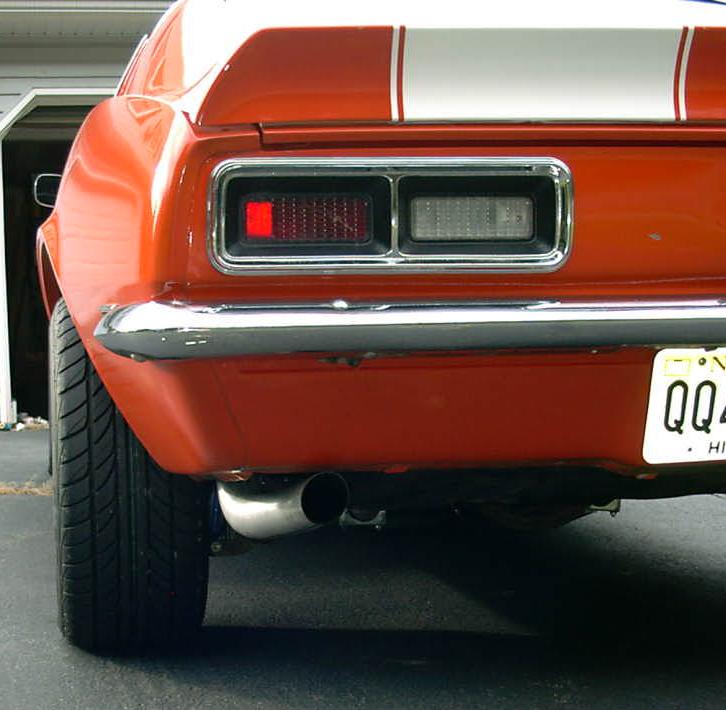

If you are going to radials. I put 15x7 TTO'S on a 1970 Nova I had with 225/70/15 up front and 255/60/15 in back and I did not roll the rear lip. If these will fit a Nova these should will fit a 67-68 Camaro. Before then I had 15x7 T70Rs that ended up on a 67 Camaro with one size smaller tires front and back. These wheels have a little more offset to the inside and there was no rubbing. You could go to the larger size tires with no problem.

The 15x7 T70Rs were sold to Jeff-San and he had the white SS/RS 67 Camaro for sale in the &quot;Cars for sale section&quot; here. I think he has one picture listed so take a look before you decide because the extra offset to the inside helped get the tires in the fenders. I was not a fan of the shiny wheels on my blue car but that is just my taste and I always prefer the TTOs. To be safe I went with 225/65/15 in the front and 245/60/15 in the rear. but there was room for more tire.

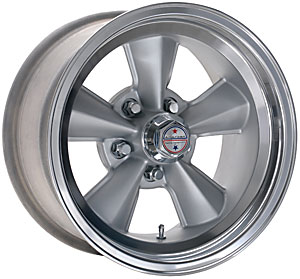

That car looks awesome........What is a &quot;T70R&quot;??? I'm assuming that's a different version of the Torque Thrust?? I'm assuming that the offset is pulled in more than a regular Torque Thrust??

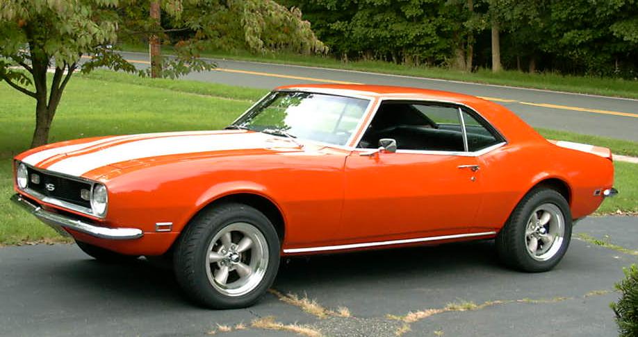

This is a friend of mine's car below.......It's got 15X7 wheels on front and back........with 205-65-15's on front and 225-70-15's on back........I like the rear, but the front needs to be taller IMHO, but he says that he's had taller tires on it and they rub at the back of the wheel opening, so I'm gun shy of trying anything taller/wider so that's why I'm here, hoping someone has a narrower wheel or different offset on the front which will allow a taller tire..........

Back in the day, I had a 68 Z28 and put TT's on it that were 15 by 7 with F70's and they rubbed on the front. Dropped back to E70's and they still hit the bright aluminum trim around the front opening. I notched it at the top and no further problem. Back was not a problem with the F70's.

The T70R is a American 5-spoke that was made for a short period of time then reproduced recently. It has a little bit of a flange on the edge of the spokes and it has more offset to the inside than the TTO 5-spokes.
