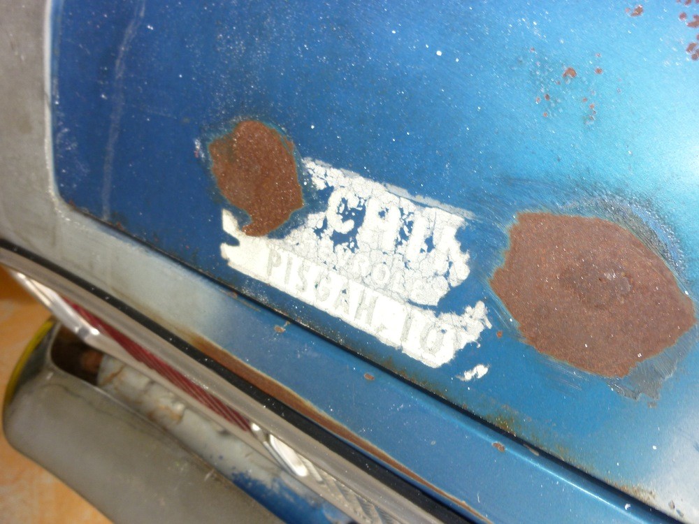

Here are some pics of the Nova.

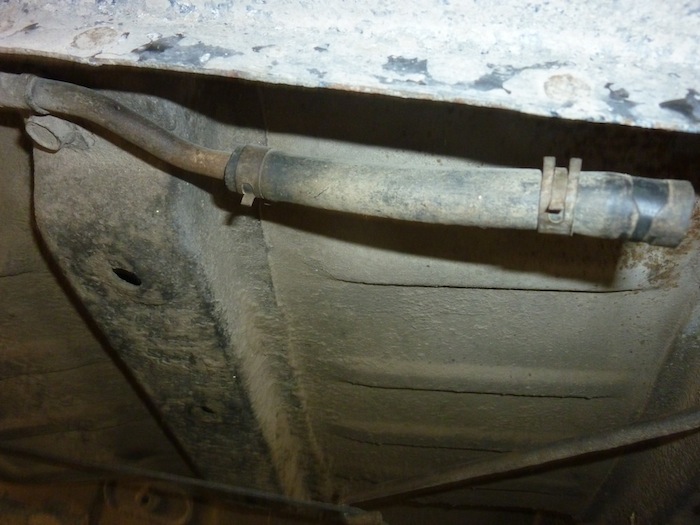

I see it had power steering did you get the pump with it if you did it would have a deep groove pulley. Take a picture of where the rubber hose comes off the line by the sender to see if its original back there

I did not get the PS pump. I'll get a pic of the line at the tank.

I like the 'A' '71' on the firewall, looks like another code is there too.
The single fuel line - and attaching clips - look original, (even has the non-safety rubber line clips), indicating an L78 version.
