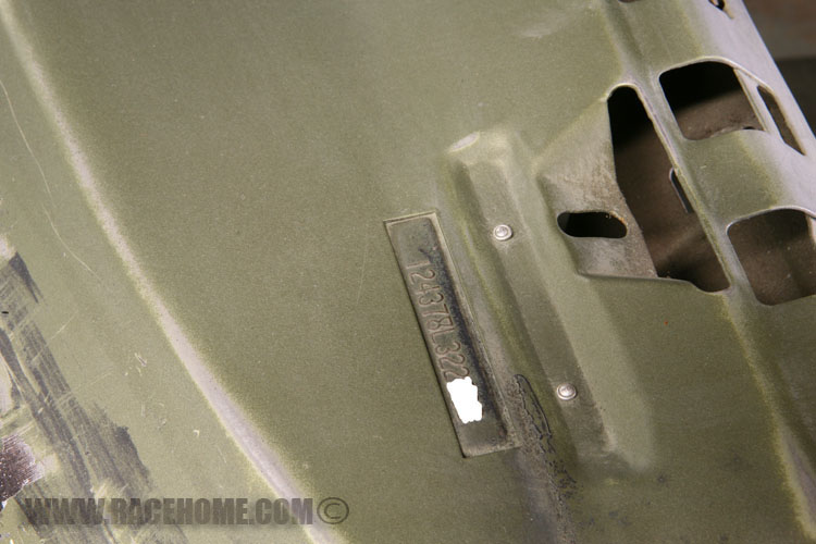

Hey guys,
I'm working with a friend on his Ash Gold exterior and Gold STD interior LOS '68 SS and noticed that the top of the dash and the metal around the rear package surround is a darker color...almost a green (I'm color blind so if I'm wrong...sorry) compared to the face of the dash which is almost the Ash Gold but slightly less gloss. There's a defined tape line on the top edge of the dash and around the rear package area. Is it common to have 2 different interior colors? The darker paint is also almost a satin finish. The tape line for the darker color is under the windshield channel.
The CRG states that the interior colors are painted first, then masked and then the exterior is painted. It looks like there is the paint from the face of the dash under the darker paint. The CRG also sort of implies that the VIN plate is installed after all the painting is done. Strange that the VIN plate has dash paint over it...but at the same time, there's no paint on the rivets. What gives?
Also, the metal under the corner trim in the package tray area always appears to be rusted, as if those trim pieces were installed before any paint is sprayed on the car. Was that metal completely bare before the trim was installed, or was it at least primed? The last 3 LOS cars I've paid attention to are rusted only under the trim like shown here.

Well, Here's another original dash paint car. You can clearly see the blue dash paint on the VIN plate with most of the blue paint removed from a scotchbrite pad. The paint is so far under the plate edges, it's almost like the plate was painted blue before it was installed. Again, notice the rivets are not painted.
Tony Huntimer

Hey Mark, this makes sense as to why the VIN plates I've seen interior color have no paint on the rivets. I wonder if this is a LOS or NOR difference. The 3 originals I've seen non-black were all LOS cars.

NOR and LOS were both random. Non-black interiors sometimes matched, sometimes did not. The tags were painted off the car and installed by Chevy after windshield installation which is why the rivets are inverted.

Mark, I don't agree - you may be looking at a body that had an interior repaired in the in-line repair booth after color. I was there (at Norwood) in '69, and the interior color was shot in the second prime booth, and masked off after the second prime oven, prior to entry to the first color booth. The package shelf corner pieces were installed prior to interior color, and were raw metal, which is why they rust.
The VIN plate process varied from plant to plant, and sometimes within each plant; sometimes they were black, and sometimes they were interior (dash top) color, painted prior to installation. The VIN plate and reinforcement were Chevrolet parts, and were installed after the windshield (which was installed by Fisher Body), with the rivets shot from below, as shown in the Assembly Manual.
