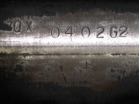

I need help determinating if the numbers posted here are real or restamped.

When was the car built? 04A 04B? Do you have a pic of the vin stamp from the transmission.

All the dates line up... the axle is a 2nd day April the engine build date is March 29th... What is the casting number on the block? Do you have a photo of the Vin on the block?
The broach marks on the deck look a little heavy. I would like to hear what some other guys think... The car should most likely be an 04A or 04B build date...

Do not have casting numbers on the block yet.. What is an 04A or 04B? Thank you for your response. What do you mean by the broach marks being little heavy?
The car has no history or documentation. I'm trying to buy the car as number matching and this is all the info I have.
Yep! I'm thinking...36 grit on a belt sander.
