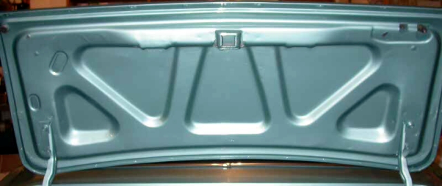

Is there a difference between the 67, 68, 69 Camaro trunk lids? I know they interchange but are they identical?

No, If im not mistaken something is different on the backside of it.

Don't the 68 and 9's have the wholes for the spoiler studs underneath?

Not the repro lids or originals. They had to be drilled into the lid to mount the spoiler. I agree with Barnfound. I think that the underskin is a little different.

The shapes of the openings on the back side are different and the date codes are in different places.

Can you be more specific about the openings? are all different? Where is the date code located on the 69?
