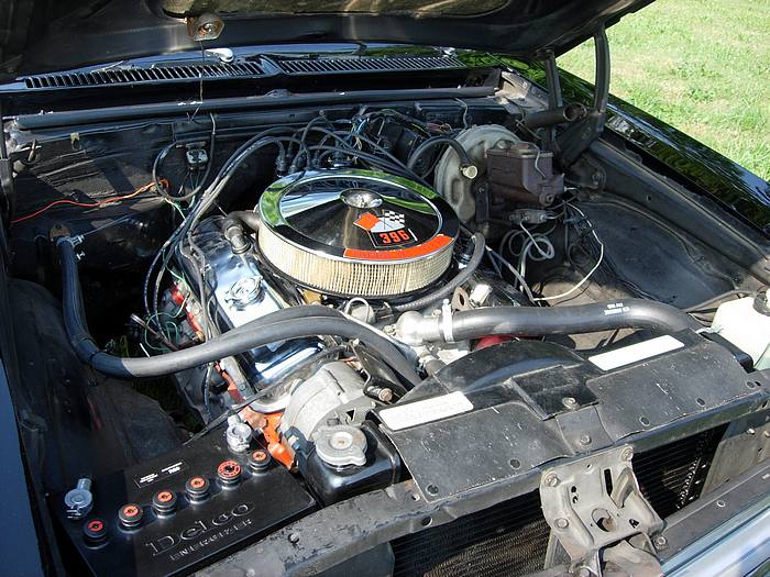

I need the correct metal clips that attach the rubber flap to the rad support for a 70 L78 Nova. WILMASBOY made a post on Steve's nova site about a guy named Benny having them but can not get in touch with him.

Joe, 1970 BB Nova does not use the metal T-clips...the 70 cars used a small plastic "button"....I know you can get these from National Nostalgic Nova. Not sure if they are sold separate or as part of a kit with the flap and bracket...I have got them from Wayne before..give them a call 717-252-4192 or 717-252-2383....tom

It thought the crossover was after the beginning of the '70 year - didn't some early '70 Novas get the metal version?

My 70 (2nd week of Sept build date) had the metal clips, which I replaced with the Plastic ones

It would be interesting to see what's shown in the assembly manual..can't find mine at the moment...

My 1970 which was built the 3rd week of 1969 still has the original plastic buttons .Bob
