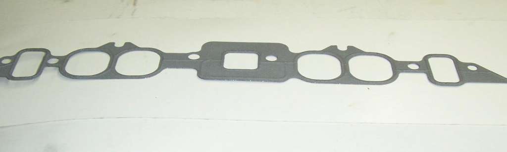

Here is what an original oval port gasket looks like.
I hope this helps.
Jerry

Jerry J.
That is it!! If you are fortunate enough to find an old GM head gasket set on ebay, it will have these gaskets in it, plus silver cork valve cover gaskets.
I have also seen individual intake manifold gasket sets on ebay that have had these. Someone sells aftermarket sets on ebay with the correct shape, but they don't have the metal sandwiched in the gasket like the GM originals.

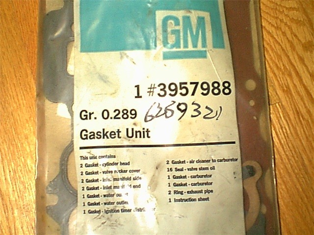

I have a NOS GM gasket set; 2 head gaskets, silver valve cover gaskets, intake gaskets, 2 wateroutlet gaskets, dist., gasket, carb gasket,2 exhaust doughnuts, 16 valve stem seals, parts # 3957988. If someone needs it.

pic

pics2
