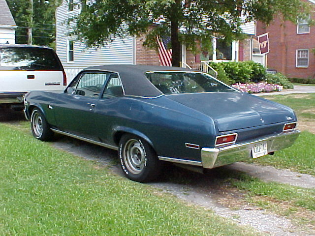

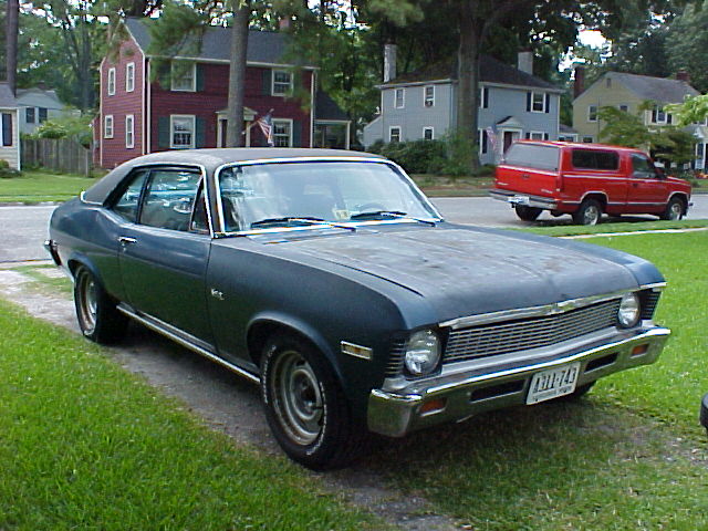

...Okay guys....I got it home...I will be taking some photos tomorrow....Here is what I got..
...1970 Nova, built 350 motor, aftermarket aluminum intake, POWER ASSISTED FRONT DRUM BRAKES, 350 emblems on the fenders, "11427" on the cowl tag, FRONT AND REAR SWAY BARS,
..15X7 RALLYS, 10 bolt rear, bench seat, auto. on column,
..get this....FATHOM BLUE...WITH BLACK VINYL TOP...
...built 6/70 ...I will get cowl tag info an photos tomorrow

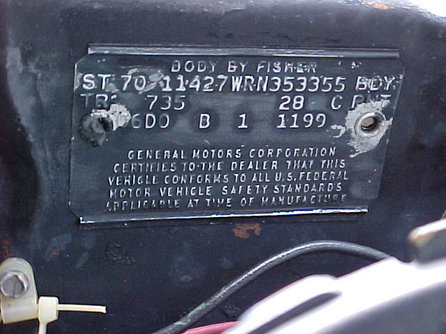

..the one question I have ...are ALL 1970 nova's with "11427" on the cowl tag "SS" models?...or does that mean it came with a V8?
....Oh, it has power steering and factory a/c too...
Old 08-22-2006, 06:29 AM
@wot @wot is offline
Join Date: Jan 2004
Location: CT
Posts: 207
Default Re: 1970 nova suspension option?
1= Chevrolet
14=Nova, V8
27=2 door coupe
The only way to verify SS is if you have build sheet with ss code or if engine #'s match vin. Certain engine options required ss package.
Dean
Old 08-22-2006, 06:43 AM
Join Date: Mar 2003
Location: Pittsburgh, PA
Posts: 1,214
The A/C rules out the possibility of COPO or L-78, but it could still be a 70 Super Sport.

Old 08-26-2006, 06:09 AM
John's Avatar
John John is offline
Join Date: Nov 2001
Posts: 3,395
Thanks: 2,797
..more
Old 08-26-2006, 05:55 AM
John's Avatar
Join Date: Nov 2001
Posts: 3,395
Thanks: 2,797
...finally got some photos...
...I don't think the rear sway bar is a factory unit...
..what do you guys think?
..here are some photos...
