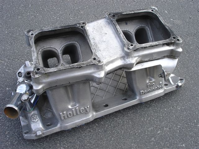

Then yesterday I was offered a 1967 302 crank (casting # 3876764) and this tunnelram intake (with Winters foundry snowflake).
So now the question is: Can I use this intake on a high-winding 283 or 302 engine ? And if so, what size carbs would be suitable ?

<font color="blue">I used to run a tunnel-ram on my
327 years ago &amp; my favorite carbs were 660 Holleys.</font>
---&gt;Holley 660 page &lt;---

Would the short runners, 5 inches from the plenum to the head, make this intake more suitable for a small cui or big cui engine ? Or does it affect the rpm-range in which the engine makes most power ?

<font color="blue">That is a big rpm intake,
it will dump a lot of fuel.
---&gt;Holley Tech page&lt;---
I used the Weiand Hi-Ram on mine.
A lot more streetable.
---&gt;Weiand info&lt;--- </font>

Thank´s Michael, that´s what I wanted to know. I guess I have to build a really high-rpm engine to get good use of that manifold.
