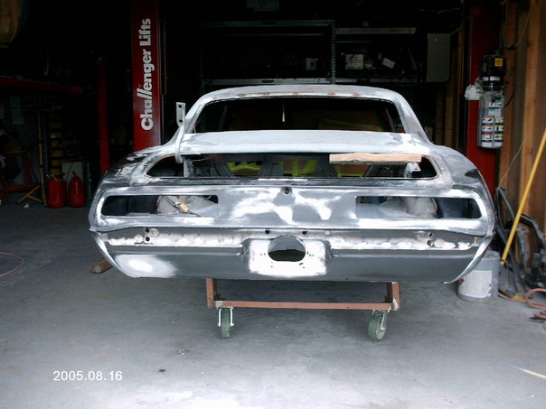

Before picture, 2 years ago...nothing like hearing this thing breathe.
