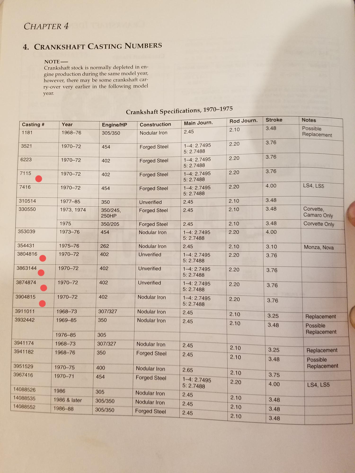

That’s an interesting list … I am curious why the LS/6 wasn’t on it ????
