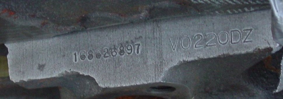

Default Engine stamping...comments ?
Attachments - The Supercar Registry 194622-DSC02229.jpg 194172-DSC02375.jpg 194171-327-68010.jpg 194160-DSC02376.jpg

closer

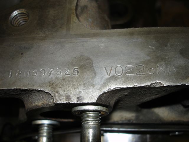

Looks suspicious to me, Charley. Block surface texture looks very different under each stamping. And what the heck does '168626897' mean

The block pad looks like it's been decked up to the V. The #s don't make any sense.

Charley, can you post a picture from the front looking down the deck surface to see if the deck surface level changes.

No I can't but the deck level does not change. Those are orig broach marks.
The stamper apparently thought that the year should be represented with two digits - '68 vs. just an 8

The V022 looks almost the same.

I think the 2's are different fonts.
