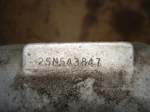

I am going to look at a 4-speed next weekend and the guy can´t tell me for sure what it is. The casing is made of aluminum he thinks.
Cast on the passenger side: 1304065903 W.G.DIV FPC2 (with the P lower than the rest) 1/8/1975
Cast on the driver side: B.W.13.04.066.901
Stamped on the driver side: WB2552
Cast on the cover: 13-04-097-90# and under that G297#
Anders

<font color="blue">I would say it's a "Borg Warner".
Whether it's a super t10 or not - </font>

I don't see anything there that looks like a Muncie number.
The best place I have found for identifing Muncie's is at www.4speeds.com then look for Muncie. Great info here. It helped me ID my M22.

An easy way to visually distinguish a T-10 from a Muncie is to simply look at the side cover. A Borg Warner T10 will have a curved bottom on the side cover, while a muncie will have a flat bottom on this cover. Muncies are always aluminum case, while some Borg Warners (not all) came with a cast iron case.

<font color="blue"> B.W. 13.04.066.901
^ ^ Borg Warner </font>

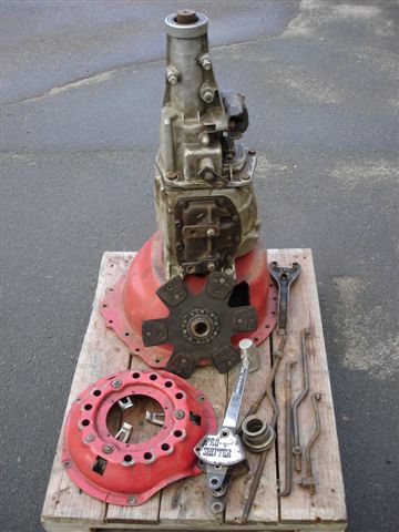

I was going to thank you guys when I received the transmission, and I got it today. Thank you !
It came with a 62-67 Chevy II scattershield and a Mr Gasket Pro shifter.

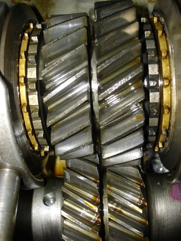

Gears

Looks like a borg warner from the oicture,side plate is corved on the bottom.

looks like a slick shifted ST-10 with every other tooth ground off the speed gears...Crash
