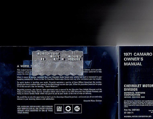

I am considering the purchase of a 1971 Z28 for my collection. Could you guys help me to ID and make sure the #'s match.
VIN: 12478N508832
Cowl Tag: ST 71 12487 NOR 102792 BDY
TR 775 62 62 PNT
09A Z28.19
I am posting pictures of the tags and PP. I will post the other numbers as soon as I receive from seller.
I appreciate any help.
Attachments - The Supercar Registry 137532-71Zprotecto-neg.jpg 137531-71Zprotecto.jpg 137530-71Zcowl.jpg

"VIN: 12478N508832" <---- Are you sure that is typed correctly. POP looks different and is more like what should go with that car.

More numbers:
Block: V0818CGP
Alt: 1100837 37at tope code 9628 12v neg bottom code
Carb: 3989021 top code list-4801 074 bottom code
Trans: P1M28 C N508832
Rear: CBG238
I really need some help to ID this b/c I don't have the resources here. Thanks in advance!
Old 05-05-2005, 07:52 PM
DarrenX33's Avatar
Join Date: Sep 2002
Posts: 5,460
Thanked 10 Times in 8 Posts
Default Re: Help ID '71 Z28
Dan use nastyz28 decode page Very good site. I decoded some of it.
Block: V0818CGP
<-- manual trans Z/28 August 18th
<---Not sure.
<---Not sure.
<---M22 But the M is throwing me off? December 28th of 71??
Rear: CBG238
<---4:10 built on 238th day of the year. That puts you at end of August.

VIN should start with 124870N for Norwood cars and L for LA cars.
