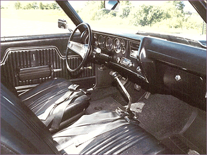

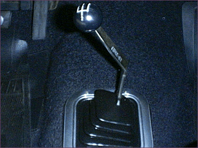

Ok finally got home and on my own computer, so I will ask for your opinion again about this shifter handle. The assembly manual shows that shifter handle (2)in the attachment shows a number 3973864 this number is stamped on the bottom of the shifter handle. The note beside the part number says M20 M21 M22 W/Bucket seats.Does this note mean
that all bucket seat chevelles came with this shifter handle unless you ordered a council.Then GM would of instaled the council shifter 3973865 leaver which has no bend?
Thanks for your opinion.

Check out the pix attached here.

Another view.

Denis
I think that your shifter is the right one. Ray from Oaklahoma who repairs muncie shifters said that the bucket seat no council shifter is part number 3973867 .He also said that the assembly manuel is not correct for the 70 chevelle. The 3973867
shifter is right for the 70 chevelle ,for the council and
for the bucket seat without concil.
First, let me say the photos are not of my car but rather the "Benchmark" Chevelle. (Let's not rehash that whole thing again, PLEASE! Dean Ribich was responsible for that website and it has helped a tremendous number of people. Yes, some got upset over the car. My opinion: GET OVER IT! Publically, I still thank Dean for what he did and he remains a good friend of mine. The End!)
Now; it is also my understanding that the shifter handle shown in those photos was used with all bucket seat equipped cars whether they had a console or not. There are members here who are MUCH better versed in this matter than I; a couple of them named Rick! Let's see if we can get them to speak up.
Calling Mr. 70 and SS427!!!
