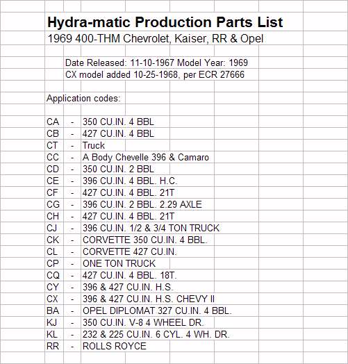

Using a 1969 "Hydra-matic Production Parts" list, I charted the differences and similarities between the "CY" & "CX" automatic transmissions, as well the difference between the "CY" & "CX" and the standard 400 automatic transmission.

Ray Morrison sent me some more 400-THM info. It was an application chart for 1969, so I went ahead and ran it through Excel so it's easier to digest...
