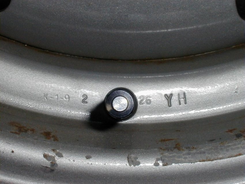

Has anyone ever seen March '69 dated YH wheels? It seems in many years of parts I have never seen or heard of a March '69 YH wheel. Maybe I'm wrong but Ebay item # 2487848412 has the most "unique" K 1 9, date and YH stamps I have ever seen. Doesn't look anything like any of my original YH wheels. Currently over $1,000 for 4! Buy it now for $ 2250.00! 200 more in the collection?! Original or not?
XT wheels are now available new. Have the YH wheels started also?
Mark
Attachments - The Supercar Registry 95795-12 18 yh best2send.jpg 95794-8 6 yh best.jpg 95793-4 19 yh best.jpg 95792-2 26 yh best.jpg

I don't see a problem with them other than the fact that the day of the month is stamped deeper than my May YH wheels. My car should have March YH wheels since it's an April JL8 car so the definitely made the wheels that early. What do you think looks wrong with the stampings?

If you had the original wheels for your car you would see what I mean about the characters. A number of people who have had many YH wheels just have never seen any dated in March '69. Maybe they ran a few or none? Enclosed are some shots of YH wheel stampings. Do you see any differences?
