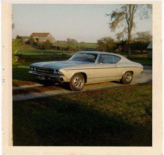

Does anyone have a part number for a front coil spring that will have a big block'69 Chevelle sitting close to stock height. Most replacement springs that I have seen end up holding the car way too high. I'd rather have the car low than too high. This is how the car sat when new and I never had a wheel hop problem. It handled reasonably well too, with the help of the F41 sway bar that I added.
