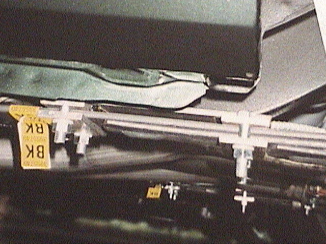

If you put spring clamps on the rear leafs, do you put a clamp at the end of each leaf? Do you put them before the axle, after the axle or both?

If you put spring clamps on the rear leafs, do you put a clamp at the end of each leaf? Do you put them before the axle, after the axle or both? - In front of the axle, it makes the springs act like traction bars. If they are worn, put in some new spring eye bushings while you're at it.

My Nova is stock and unrestored. As in original springs front and rear, with UAP NAPA 50/50 shocks on all corners. I do put two clamps on each side ahead of the spring, mostly to help not spit a driveshaft.
