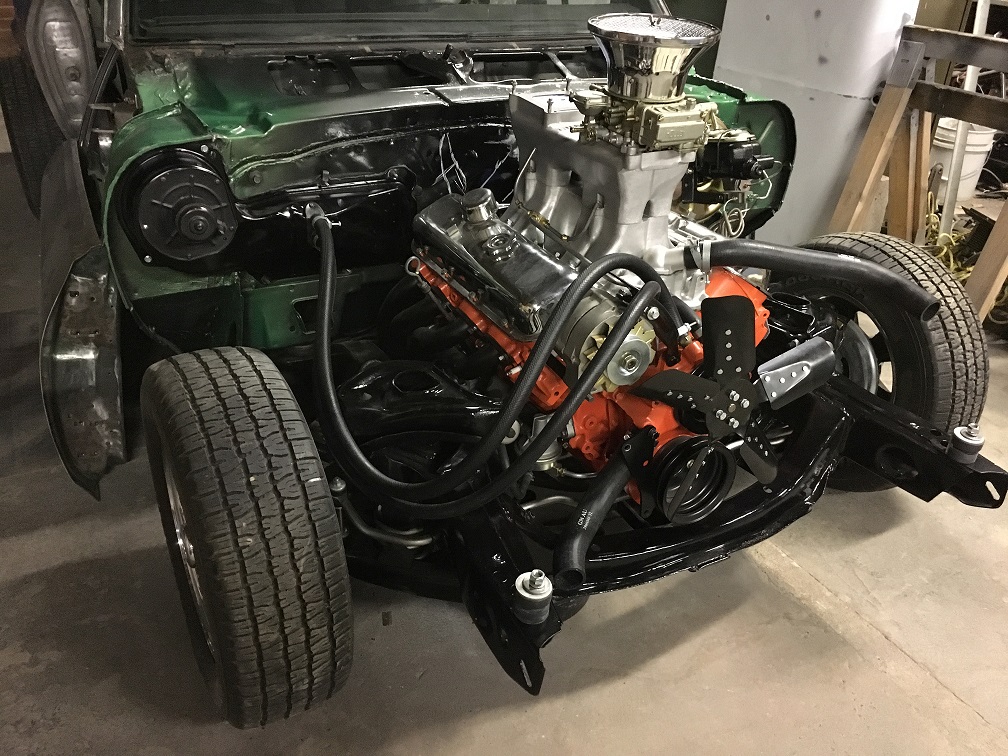

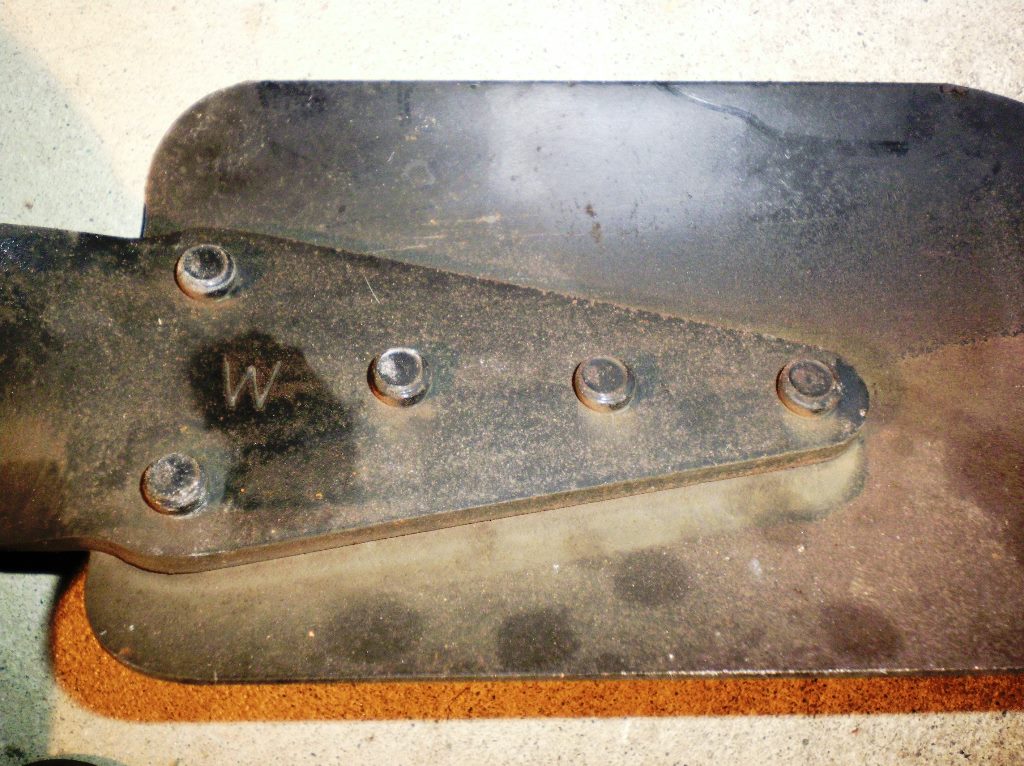

What type of fan was used on a 69 L78 Nova ?
I have seen a 4 blade non-clutch fan and a 772 7 blade clutch fan mentioned not 100% sure ?

I have seen only a 4 blade non clutch setup on early cars and then a switch to a 5 blade non clutch set up later in the year. I have never seen a 772 clutch style used on a L/78 Nova. Ask Rowdy Rat to help out too..BKH

I have a March built 69 L78 Nova...It has a five blade fan.

Thanks for the info my car was built in May 69 so I assume it would have a 5 blade fan. Do these fans have a part # and a date code ?

Found the P/N on the 5 blade fan on my 69 Nova L78.
It's 3947824EV Can't confirm its the original however.

Both engines used the same fan...these fans were notorious for the noise they made as the rpm's went up...most of them were replaced back in the day with a flex fan. Interesting thing is, they actually worked pretty well at cooling the BB motors.
Again, there is a lot of stuff out there about what fan is correct...based on all the info I have seen, including survivor cars, there was never a 4 blade on these engines.
