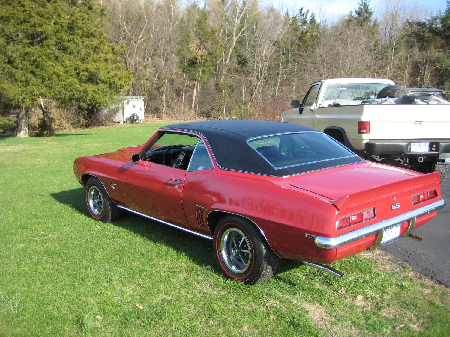

Considering a 'winter engine build' for Karen's 69 SS 350 Camaro. Car is a beauty...Garnet Red, black/white houndstooth, black vinyl top, M20 4spd, console gauges, 5 spoke magnums and redline radials, Gardner exhaust,.
Current small block is NOM...pretty sure the rear is 3.73 or 4.10...will have to check closer. We have a 1968 350/295hp engine...good shape. Thinking about a 383 stroker build, hydraulic roller, better heads. Would likely add an Gm performance aluminum intake and retain the QJ.
This car will run with manifolds, no headers.
Karen would like to increase the 'go-pedal' factor, but not go crazy.
Thoughts and ideas are appreciated.
