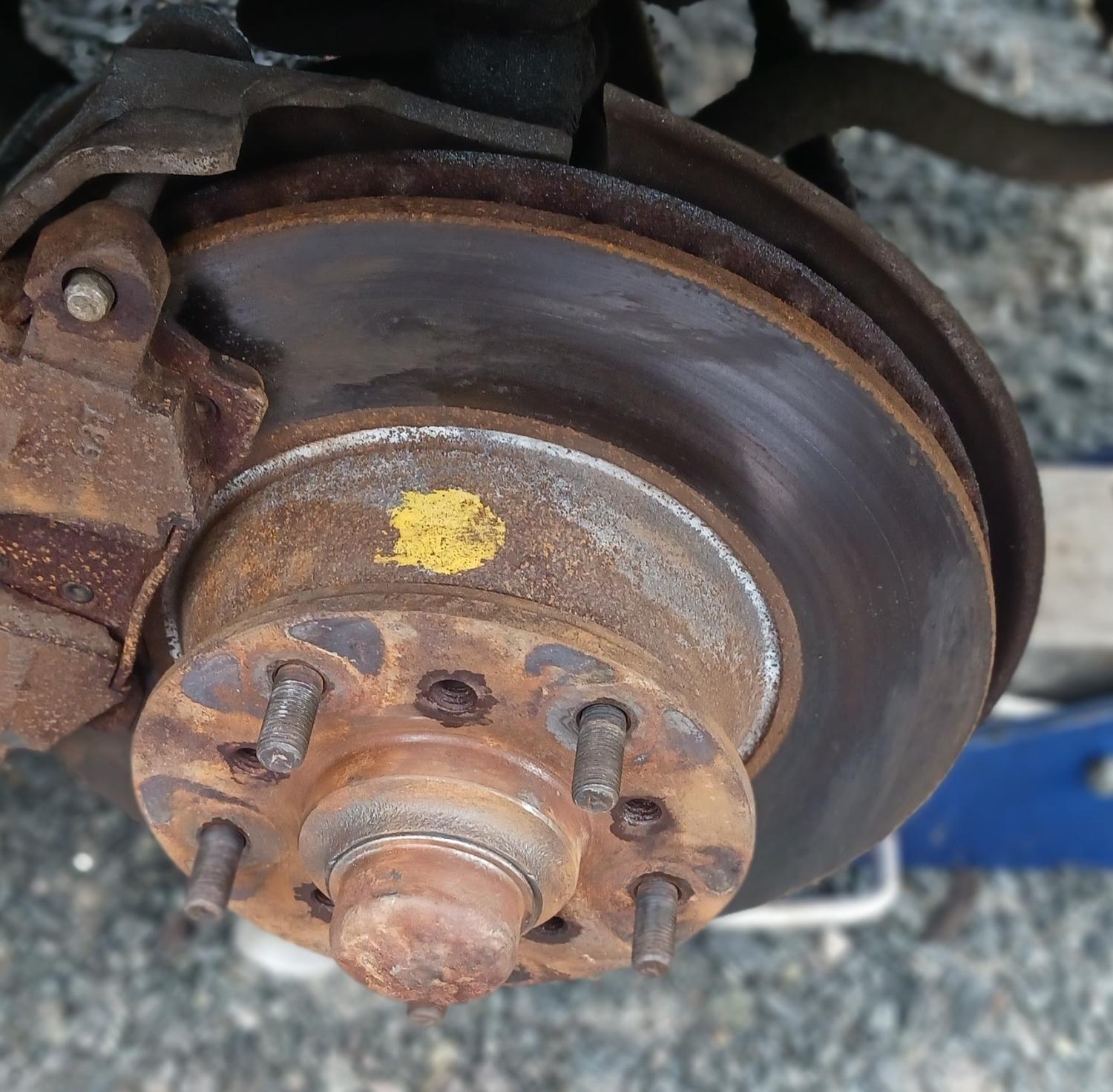

No opinion on stamp for lack of study.
Looks like someone spent a lot of time on the car .
Tag on tranny is for sure rusty.
309 master cylinder is a re-pop.
Just completed the "309" marathon with plenty studying.
Looks to be plenty other re-pop stuff on car.
Driveshaft strips are nice and neat.
Factory driveshaft stripes [well on "OLE BLUE" anyway] are very sloppy. Obviously done with a brush.
Other paint markings are very sloppy also.
A few example's
