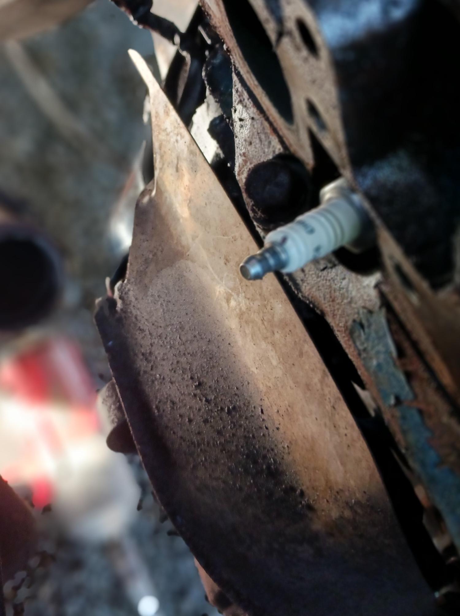

Need confirmation on the size of this Starter heatshield Hex Head,is 5/16-18 X 5/8 what was used originally?
Attachments - The Supercar Registry obstarter heat shield.jpg obheatshield.jpg obbrokenstudheatshield.jpg heat_shield_bolt.jpg

Cannot find a good pic of it but it looks like a corner oil pan bolt??
The tube nut is not on rear solenoid screw, but we have it.
Did not take bolt out to check but it has a lip like pan corner bolts.

Shows as part number 9419370.
Punch that number into epay and you will get multiple choices.
Your size is probably right and these "assembly line correct" offerings have a lip like hers.
Cannot verify the head marking as her car is still put away.

Here is a pretty good picture...

Thanks guys,but still looking for exact dimensions if possible.
Mr70,
9419370 was a bit elusive in GM docs. I found a reference in the Parts and Illustration Catalog M-SB September 1987.
9424877 Bolt, Engine Oil Pan 5/16x18x3/4 300M STL *REPL 9411911, 9419370
The Oct 1969 P&A24 Lists the replaced part numbers as:
9424877 5/16-18 x 3/4 . 300M (300M = Chrome Nickel Steel)
9411911 5/16-18 x 3/4 . W/washer 280M (Lock Washer)
I hope this helps,
Greg

Another look at a 1970 [according to ad].
Sure looks to be 5/8" to me.
Has lip also.

It does,Thank you Greg.
