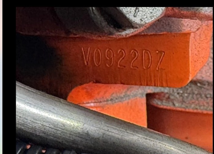

Maybe it is just the angle of the camera, but doesn't look right to me.

Nfg, imo.

Freddie

Nothing correct on that stamp or pad IMO! Nice grinding marks on pad.

As someone who’s not familiar with the DZ stamp or pad anyone have any pics of others?
Just in case I run across one of these .
I’m guessing that block is the one (somewhat ) in my neck of the woods there’s also a crank local to me.

There are variation base on month &week. We don't want to educate the restampers so we usually will respond with original or restamp. Kurt/CRG have a huge database and I and others have stampings that we've collected for 30-40 years.
