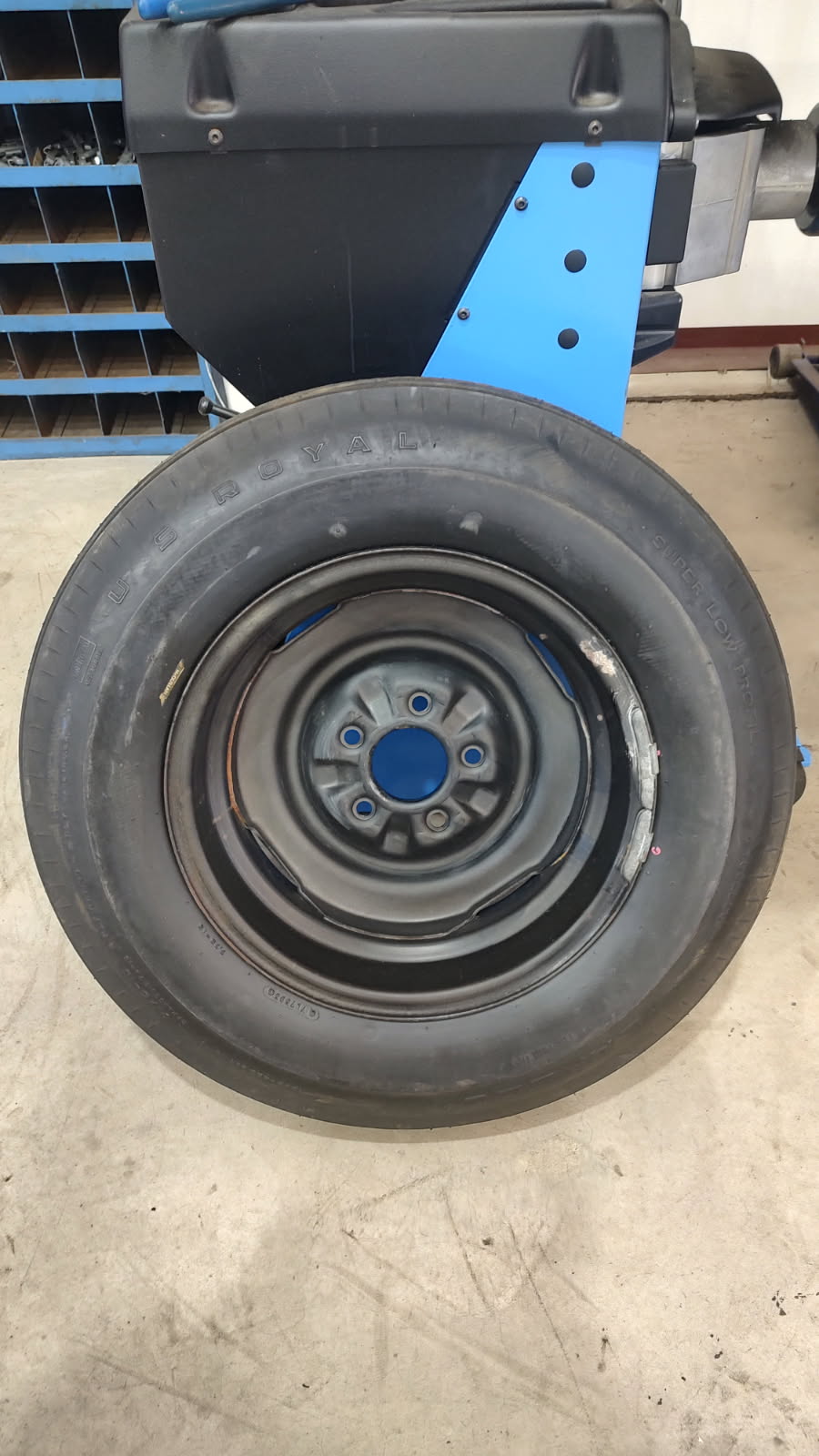

I had ordered up a set of tires for the car right after it landed. When purchasing the car, I was told the tires were new back in 2022. He wasn't lying, they were new TO THIS car. They were reproductions from (what I figure) back in the 90's. Made in Argentina. They were just about as hard as some of the original non DOT's I've mounted and dismounted. The spare is the original Firestone Deluxe Champion, so I followed suit with the new skins. Another little surprise, was none of the wheels were original to the car. They were all 15x6 (should be 15x5.5). One of them was not even a GM wheel. Luckily, I had a nice survivor set of 65-66 wheels at the shop.
Today's task, get this installed.......
