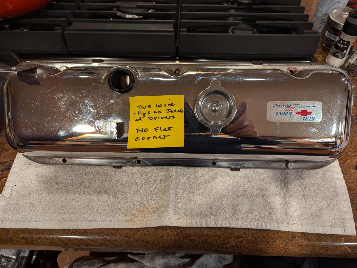

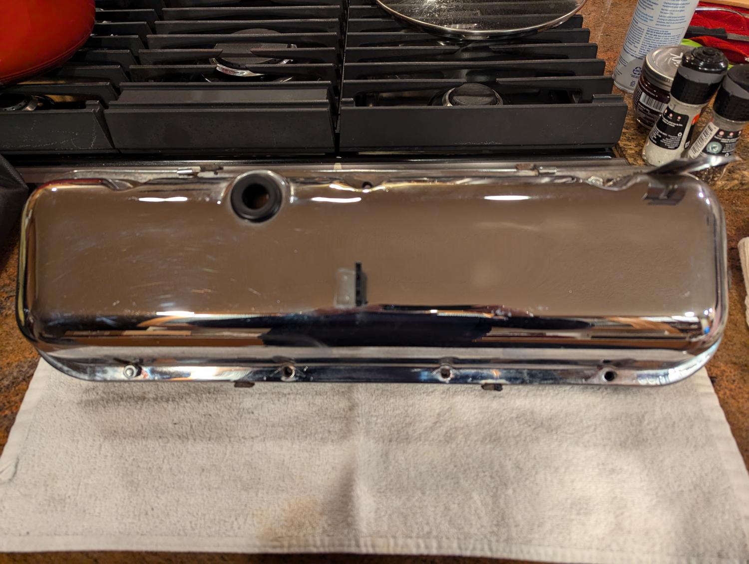

I have what I assume(d) was a matching set of OEM Big Block Valve Cover
One of the Yenko members offered me the below opinion.........
I'm now asking for YOUR 2nd Opinion as I feel that these two (L&R) covers
are a born together set from ??????? (Car Model/Engine/Year)
"That is not a matched pair of valve covers in my opinion. the passenger side is 100% for late 68-69 up for Camaro Chevelle Nova etc
The drivers side has the 2 small clips on top for a temp sending wire so it is not for a 68 or 69, it is for 67 IMO, but not correct for Camaro because of the top right plug wire stand. The temp sending wire for a 68 is not routed on the valve cover. It is definitely not correct for any Camaro Chevelle or Nova."

http://www.camaros.org/engine.shtml#bbcover

Originally Posted by William View Post
Chuck, This is exactly what I was trying to explain to you, go to the link & read about the changes in the LH valve cover because of the temperature sending wire. Also The top rear plug wire stand on either side of the top rear bolt hole is a big indicator of application.
