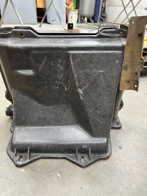

I purchased a 1969 camaro x44 that seemed to be plain but on further inspection. It has a factory big block heater core and the plate on the driver side. Before I looked into the car I sent it to a body shop to put lower quarters in but otherwise a pretty solid car. Is there a way to look up the vin to see if it's a yenko copo or zl1? I know there is no way I get lucky but the car is since been fitted with a small block and suspension modifications so I can really look into some of the other things. I thought it was weird hours after I bought the car he was offering to buy it for a lot more and even threatened legal action. The car is in the body shop now so I'll have to call him to get any other info. It's also a muncie 4 speed car.

You are right it was a E. Alpt of things have been changed on the car. Aftermarket disk brakes, radiator, Moser rearend.

What I thought was a big block heater core (fenders off the car) turns out to be a factory AC car. Was the Big Block heater core still different on the AC cars? Cant seem to find any info on it. The two holes for the Small Block are not open. I assume the AC unit did both heat and air?
AC means it's definitely not a COPO 427.
