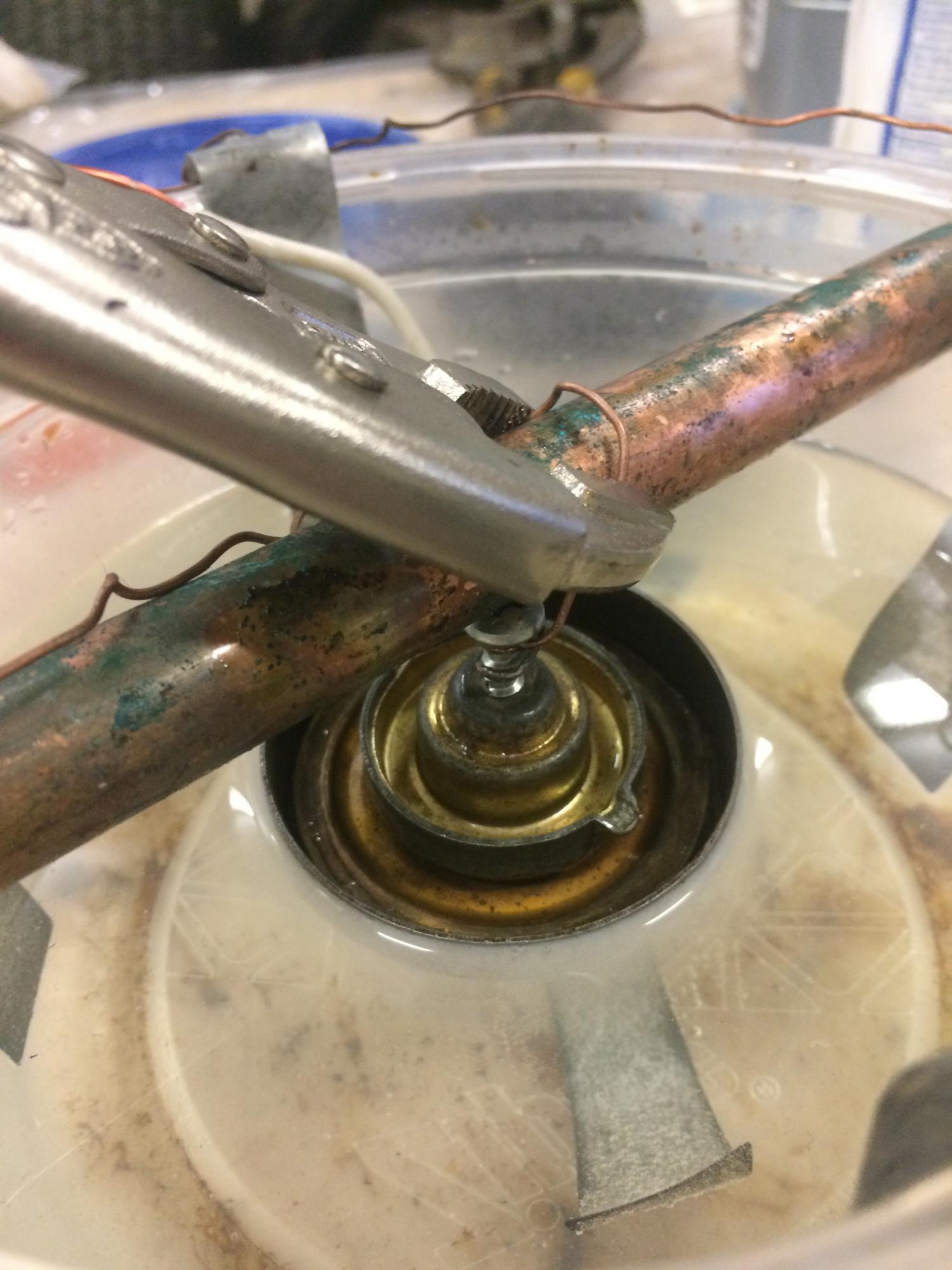

If a person were careful and plugged the openings well, I see no reason why you could not zinc plate with a gold dichromate finish just the bottom without disassembly. You may have to build a jig to hold it perpendicular to the zinc bath. Caswell can set you up with a kit.
Gas cap example:
