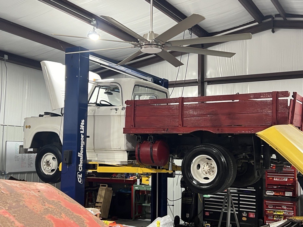

It's time to purchase a 2 post lift for my shop. I'm looking at 9000 lb overhead lifts. I see several listed for around $2100 to $2500. Atlas, Tuxedo, Racer Direct, Nationwide. I did a search on this sight but didn't get much results. What are you using and how do you like it?

I have a Worth Equipment 7000lb floor plate model.
Quality of the lift is great, and it's made in USA.
I bought it used, so it was about half price of new.
I use it almost daily for my own projects, not a business.
Floor plate style (cables run under floor plate instead of overhead) sucks for many reasons, but it's the best I could do with 10' ceiling.

I have a Bend Pak 10,000lb asymetrical and love it. I’ve owned it for ten years.
The asymmetrical's are great....unless you own a mid engine 'vette...
Makes getting into and out of the vehicle so much easier.

Thanks. I was looking at symmetrical, but I guess I should look at asymmetrical.
Like Mitch said, it does make getting in and out of the vehicle a lot easier.

Asemmetrical lifts are handy , advantage to symmetrical is you can point vehicle either way if that is a consideration .
