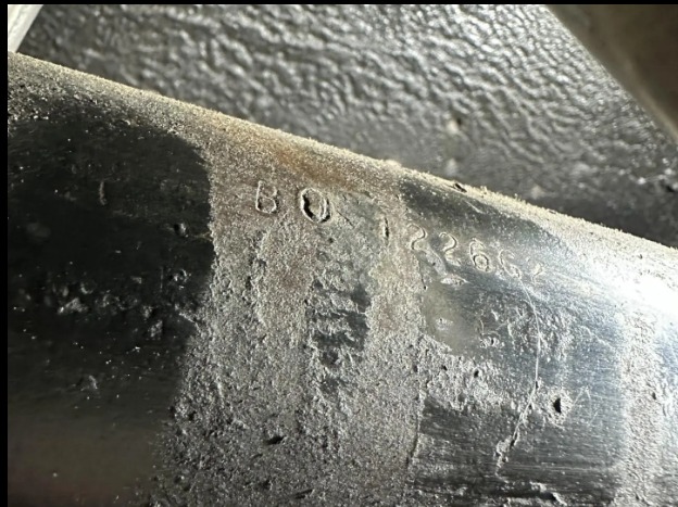

Has a 388 block with casting date of K-16-8 and a rear is a BO1226G2
124379N609445

If the vin ends in 609445, wouldn't it be a March car?
Would the 02D tag be too early for the VIN. CRG says last car out in Feb. was 607164.
Educate me.
Partial vin stamp by the oil filter is not original.
November 16, 68 block assembled in Feb. 69? Pretty hard to swallow.
Block could have been swapped since BJ. No pic of the casting date in current listing.
Sits a little high in the back for a Z. Would like to see a pic of the rear springs from the side to see if it is four leaf.
Educate me.
The last car out on Feb 28 may have been 607164, but there were alot of 02D cars unfinished going into March.
Its the same block as back in 2012. Its a 388 block with a November 68 casting date. Kurt S knows the car.
Go read the camaro.net post. Tells you all you need to know about the car,

VIN on block almost looks like something under it. There is a bare pad picture on the camaros.net thread and I don't like the stamp there either.

I read it. Sure looks like the same pad stamp.

That rear axle stamping looks altered also. The O in the BO stamping looks to be stamped over.
