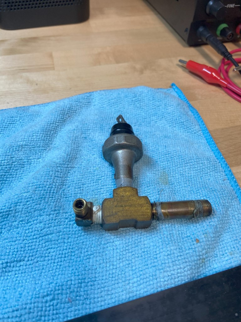

This amazing example of day 2 engineering was installed by the original owner of my 69 Z for two oil pressure guages...
Name:  oil pressure connector.jpg
Rob
